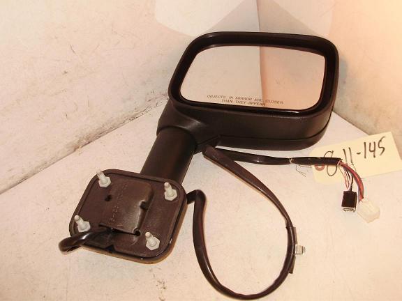

Well, didi not know this but evidently, 2005-2006 and 2007-2008, plugs are different, so if trying to use 2007 or 2008 mirror to 2005 or 2006, it is different.
I have seen the diagram that is posted here, but I am such a idiot that cannot read what goes to what on the actual plug.... Wire colors are different as well on 05 to 07 or 08. Anyone has a good insight on this? Worst case, I may have to sell the mirrors I have and hunt ebay again for 06 mirrors with Blue and Black plugs....

okay, I just went out to see the wiring. 13wires on driver side and 11 on passenger side.
Driver side actually has 13 wires
Red
Dark Green
Purple
Dark Blue
Light blue
Yellow
Light green
Yellow
Pink
Black
Gray
Brown
Gray
Passenger side:
Dark blue
Dark green
Purple
Red
Red/white
White
Purple/white
Black
Black
Gray
Brown
Now, would this be from 2008 H2? Now I am really puzzled...... Most of the mirrors have 11 wires..... Also, the plug is black and white.

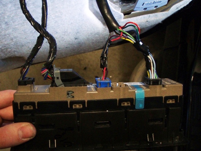

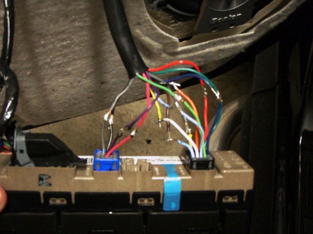

Ok so I have the Pictures now, They are not the best quality but it should get the job done. I can not promise this will work for your truck but I have a 2004 H2 and this is what worked for me. 13 wires all together. After Cutting the plugs off the old mirrors I wired them up to the new mirrors. and it looks like this.
Name:  P4060042 Resize.jpg
So you should be able to see the wires are connected in this order
Old mirror plug Skematic
Blue Plug
Empty Empty Black Purple Empty
Empty Grey Pink Empty Empty
Black Plug
Yellow Orange Red Green Blue
Light Blue White Light Blue Light Green Empty
Order to wire the New mirror to old Plugs
Blue Plug
Black Plug
Grey Black Red Green Blue
Brown Yellow Light Blue Light Green Empty
You will notice that there are a few wires that are the same in color. I am not
sure if these connect to different parts but if you get it wired and the mirror
does not work properly then simply switch the same color wires untill you
find the right pattern. I got lucky and it worked the first time and I stress the
lucky part. A final tip is to twist or solder them together separate or tape them
then pull the window and mirror control box out of the door panel and
plug up the wires to test before final assembly. When right assembly is
achieved then tape and pretty it up. Best of Luck
And when finished should look something like this
Name:  P4060043 Resize.jpg
Thanks guys I hope this helps, and a big thanks out to Lone Palm for the walk through on this
