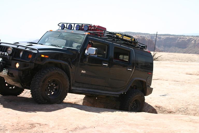

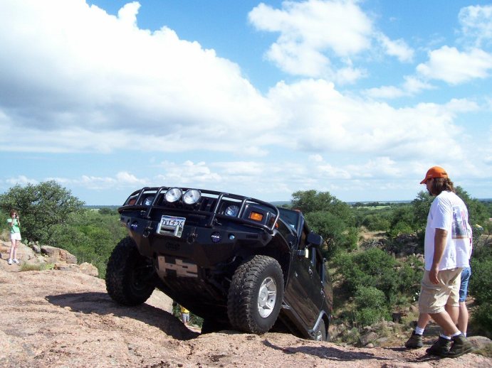

37s, no lift. Offset wheels eliminated the rubbing.
Old 12-22-2005, 06:03 PM
Alec, that's a nice winch bumper. Where'd you get it? And I thought you had the rear of your truck lifted about 10"s when you were in Moab.
Much better, Stacy.
Adam, that's a nice pic, brother.

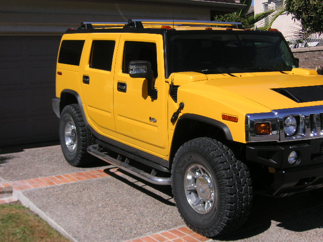

well i got the front leveling kit and 5000 miles and no problems,
i'm running 37x12.50xR17 Procomp Extreme a/t's on the stock wheels and even with the leveling kit, i have a slight rub at full turn. i would go with the 37" and crank the torsion keys a bit and you should be fine, just go with a 12.5 wide tire.
