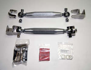

info off " The Aluminum Association, Inc" website.
Aluminum plate is used in the manufacture of aircraft and for fuel tanks in spacecraft. An airframe of a modern commercial transport aircraft is 80 percent by weight (MNAB Report #476, "New Materials for Next Generation Aircraft"). Structural components of current United States Navy aircraft are made of fabricated wrought aluminum (forged, machined, and assembled parts). There are efforts underway to persuade the Navy to adopt aluminum casting technology which offers lower manufacturing cost, the ability to form complex shapes, and the flexibility to incorporate innovative design concepts.
Aircraft manufacturers use high-strength alloys (principally alloy 7075) to strengthen aluminum aircraft structures. Alloy 7075 has zinc and copper added for ultimate strength, but because of the copper it is very difficult to weld. It anodizes beautifully. 7075 has the best machinability and results in the finest finish.
http://www.aluminum.org/Content/Navi...t/Aircraft.htm
I think it would be strong enough for our applications.

Aluminum alloys would be a much better material for a tie rod. First the strength is not an issue, they can be made as strong as needed. Secondly and more importantly they would be able to absorb more abuse. Aluminum gives more that steel and can "flex" some without distortion. It just costs much more to fabricate aluminum parts compared to steel.

Most of the information that I have seen on that type of solution is that the heim joints don't hold up well for street use. I saw a 6"
lifted H2 at windrock that was supercharged and was running 38.5" boggers. Last year he broke four tie rods on one hill and this year he had a similar setup to the ones you have pictured from supposedly SMA. But I was told that after the event his heim joints were worn out.
I will be trying out another set of the Rubber Duck 4x4 tie rods this next week at Kinsalow and will let you know how things work out.

Thanks for all the good info. More than I have seen for the H2 on here. However, we may very likely trade back in our H2 afterall. We will be losing money but we feel that we should not be having to replace parts like the tie rods to bring up the quality of a rig like this. The tie rods are an obvious weak point and dispite the fact we have a mild lift we should not be having to improve the parts. We have been building rigs for over 20 years and this is the first time this has happened. Too bad, we really like the H2 otherwise, but we bought it to use it as advertised, not to commute in. We don't feel safe going out on even a mild trail without something else breaking. Good luck to you all who use your rigs.

Yes you're totally right. You'd better return the vehicle immediately. God forbid you have to replace a tie rod. Thats reason enough to take a 15-20K loss.
You might try the tie rod replacement before you throw in the towel.
What else have you broken that has made you so skittish?

The first time out after we bought it we were climbing a similar hill to the one on the Hummer outing last Saturday along with the Land Cruiser club we belonged to. We made a couple of attempts to get through a slippery spot and decided to give it one more try. We heard a bang and found ourselves with the front differential literally busted in half, the transfer case was toast, the passenger side tie rod was bent in half and the rear end had parts sticking out of the rear cover. This was with the rig completely stock. (Did I mention that none of the other rigs doing the same thing broke during the trip?). The first outing with the dealer Hummer Happening we were going down the same wash board road as the other dozen H2's and suddenly found the steering wheel turned to the left . We pulled over to find both front ball joints at the "A" arms had come completely out of the sockets they were pressed into. We were lucky and found a local guy who had a welder to tack the ball joints on so we could get back to the dealer (Did I mention that we were the only ones who broke anything that day?). It now had the lift on it but the service manager decided it was because of the first breakage that weakened the ball joints. This was the third time going out trail riding with our rig. Then the forth time out, sure enough, for the third time doing what every other rig was doing, we bent the wimpy tie rod on our $60K "Like Nothing Else" rig. My first thought were that folks on here have been through this a LOT and maybe would know of some good "fixes" for this tie rod issue. Understand that all of these breakages happened while doing mild, ordinary 4x4ing. The more I thought about it the more upset I got thinking that I need to consider paying somebody like Fly-n-hi $710 for a couple of tie rods to fix what shouldn't need fixing. I have the same parts and lift on my 1-ton dually which has been through a lot more with no problems. What can I expect if I go out by myself and wife camping and come up to a little hill I need to climb?
We were really hoping we could make it on just one outing without busting something else. I know this forum will blast us for saying all this, and believe me I hate coming to this conclusion, but I don't feel the H2 is what it is advertised to be. It might be fine for those who like fixing broken parts all the time or for those of you who never see the dirt, but I need something I can depend on. Damn, I hate getting rid of it, but we want to USE it.
partsguy -
A windshield wiper breaking out in the middle of nowhere isn't exactly the same as a busted tie rod. I understand what you are saying about the tie rod going before another more important part does, but these tie rods are bending WAY to quickly. It isn't just the tie rod, I am afraid of what's next.
Sorry for being long winded. We may change our minds again before the hour ends but I'm frustrated.

fly-n-hi kit
$950.00 + shipping- tie rod kit
$1650.00+ shipping- tie rods, pitman arm, idler arm.
