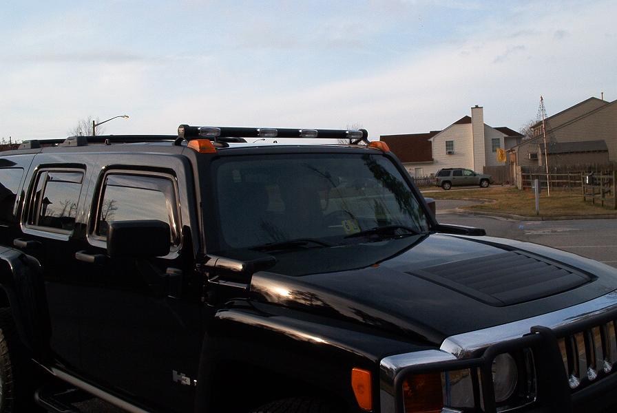

Just finished installing the corner lights with the XTC lightbar. It looks awsome, but it was a pain in the ass. Did I mention GM is a bunch of friggen crooks. $45.00 a piece for the lights, and they do not give you the outlet, the lights, or the screws. I pieced everything together from Pep Boys, and it worked pretty well. I would definately recommend putting the corners on with the off road bar.

Sorry, lets try this again!!

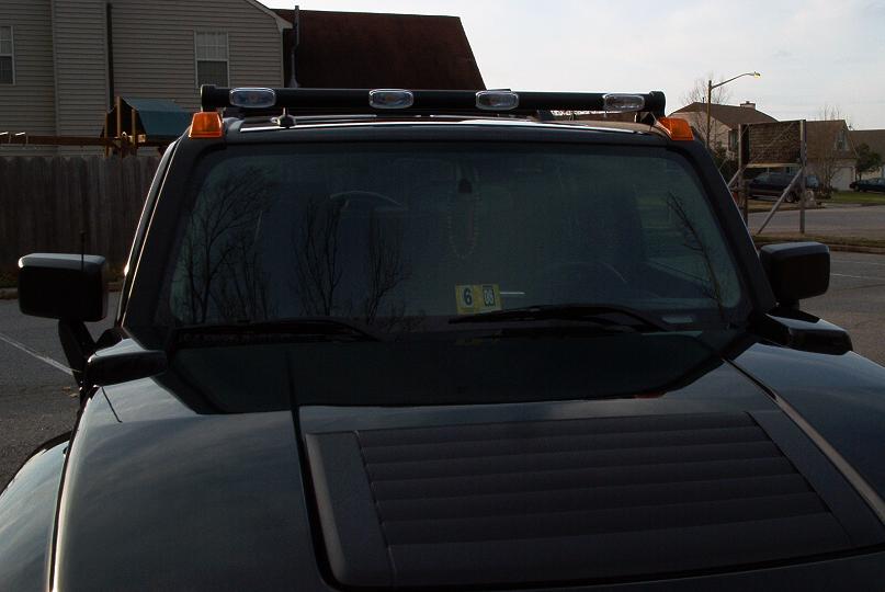

Another one.

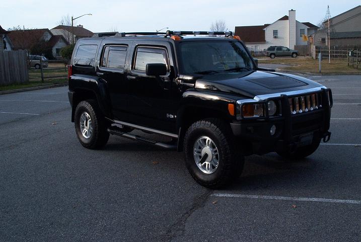

Front view

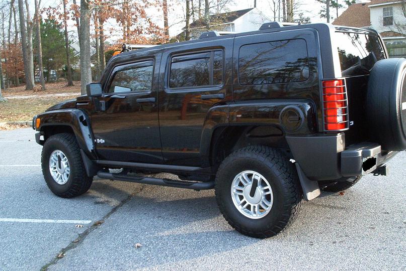

Another

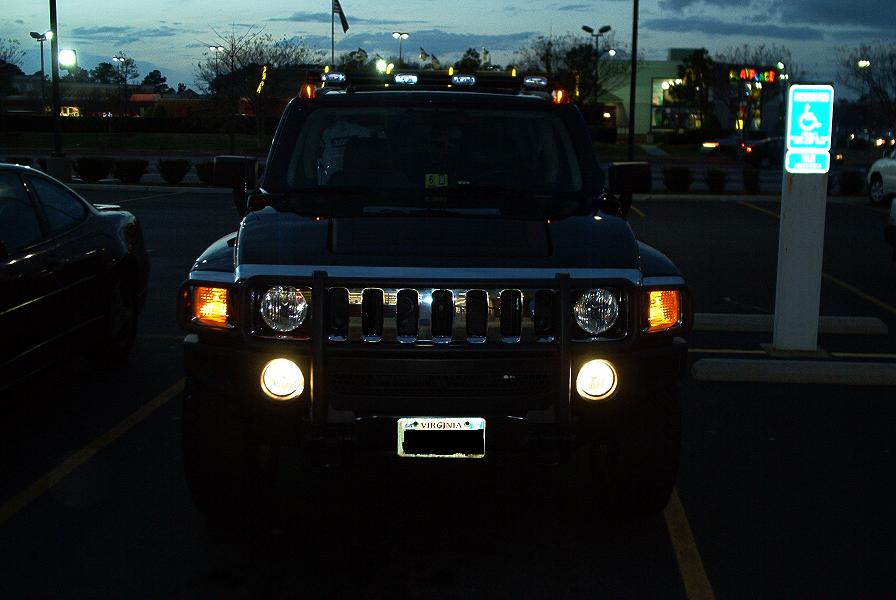

Lights on. They look dim in this pic., but they are bright.

Thanks for the pics. They look sharp, very nice combo.

how was the install on the rear lights guard ? They look like the Manik ones I just ordered, i'll gladly take any installation tips you can offer (i.e. tail lights removal)....

Installation was a piece of cake. Remove the inside screws(2), and pull the light straight out. Mount the guard with the existing hardware, and re-install. One note of caution, make sure you adjust the guard before closing the tailgate, or it might make contact with it. When you get them you will see the bottom screw has play, so push the light guard away from the gate, and tighten. Once you do this, you can tweak it to make the space even. It will be clear as mud when you get them!!

they kinda look like little devil horns in the night picture...
