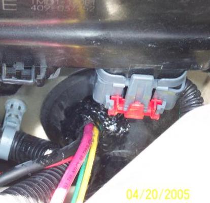

Rack and all wiring are installed and working perfectly. Finished things up last night with RTV-silicone in the roof grommet. Ditto on the firewall grommet, which is now unofficially known as the Hummer Hymen. (I swear the truck screamed when I penetrated it with the X-acto.)

Rod, you don't really think we'll let you get away with dubbing that thing the Hummer Hymen and not posting pictures, do you?

Pictures of the rack and cam are coming. And if you want a picture of the firewall grommet all busted, shiny and sealed, say the word and I'll post it, too, although the whole poke-it-'til-it-splits ordeal still makes me nervous.

Yeah, gotta have the pix.

One Hummer Hymen pix . . .
