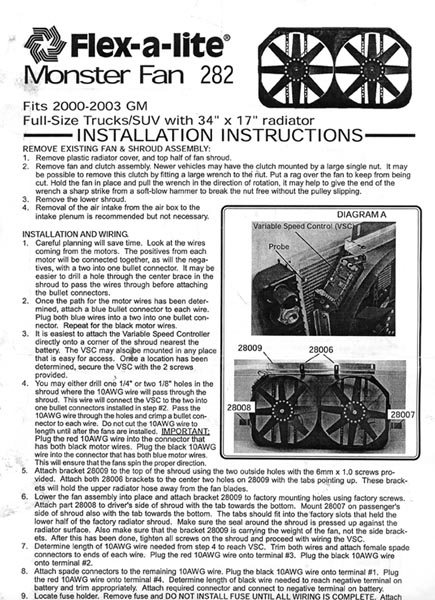

The 282 Flex-A-Lite moves 1,000 CFM more than the 295 & is for the H2 or any number of GM's with the 34"x17" radiator. I'm not suggesting it's better than the HD GM fan, simply that it moves far more air than the 295 series.

The 282 Flex-A-Lite moves 1,000 CFM more than the 295 & is for the H2 or any number of GM's with the 34"x17" radiator. I'm not suggesting it's better than the HD GM fan, simply that it moves far more air than the 295 series. </div></BLOCKQUOTE>
It took some digging (the girl friend had filed stuff away) Anway I found the install instructions for the fans that are installed on my H2. They are the Monster Fans 282 series. Just thougt I'd let you know. Thanks again for the suggestion.

Fubar, the instrcutions don't address three issues that i cam across; drilling out the top bracket slots to make them bigger, relocating the oil cooler lines and trimming the side brackets. I haven't finished yet, but so far those three things need to be addressed outside of the instructions provided. </div></BLOCKQUOTE>
Phil,
Sorry to here you are having troubles with the install of your fans. I had the dealership do the fan install when the SC and header were going on they had the truck for a week. I'm certain they had the same issues with the fans as you are experiencing. They install around 10 units a week or so I'm being told so they have probably figured out a way to stream line the install or they've simply tooled up to address the issues. I've read the flexlite instructions and you are correct they don't address any of the issues you have pointed out. I am surprised to here about the oil lines. I had spoken with a flex-lite rep on the phone before deciding to have the dealership do the install with the other stuff being done to the truck and the didn't say anything about relocating or extending oil lines. They made it sound like it was a simple drop in install. Hearing about your troubles only confirms my decision to have someone else do the install I'm not the most mechanically inclined person on the planet.
Keep plugging away you'll get it done.

Fubar, the instrcutions don't address three issues that i cam across; drilling out the top bracket slots to make them bigger, relocating the oil cooler lines and trimming the side brackets. I haven't finished yet, but so far those three things need to be addressed outside of the instructions provided. </div></BLOCKQUOTE>I had to drill out the top slots for the bigger bolts, & deal with the trannie cooling lines. I did not have any issues with the side brackets when installing the Flex 282 they dropped right into the factory slots without issue.
