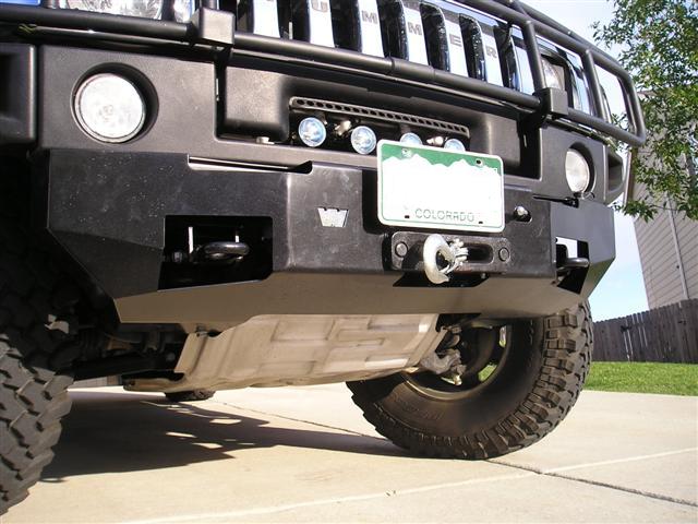

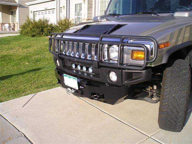

The reaon I asked is because I didn't see it on the H2 in the pictures posted above??? <HR></BLOCKQUOTE>I figured that. Those pics are from when I changed out my DRLs to Cibie Tangos. I didn't take any pics before I got started and just used those for reference. I just put up some new pics with the bumper almost finished and I now have a black grill and the light bar.

I just painted my grill black today... <HR></BLOCKQUOTE>I am going to have to end up doing something to get all of the blacks matching up front. Between the grill, the lower grill, the brush guard, the light bar, the plastic on top of the bumper and the bumper itself, there are all kinds of blacks going on.
I bought a new black grill and still have the chrome one hanging up in my shop. I probably should have had it prepped and painted so the blacks would be closer.

Went out to finish up and I don't think I got any further. My Cibies are giving me a little problem getting the bumper to line up and bolt down properly. I think I can come up with a simple fix for the Light Bar problem but either need to go buy something or make something BUT I don't have anything up here to make anything. All of those tools, metal and stuff is down at the ranch, so that will have to wait.
Now, the POS cable is definitely not long enough to route the way the instructions explain. I am going to try a few options to remedy that problem but Tracey said Warn would take care of this problem.
My suggestion to those that have not started yet is to get Warn to replace the control box. Let them re-do the bolts so that it mounts properly and also add length to the POS cable. That would save some hassle.
Right now I have one of the big bumper bolts cross-threading because of the misalignment due to my Cibies and I guess I am going to have to put a cheater bar on it to get it to pull up the rest of the way.

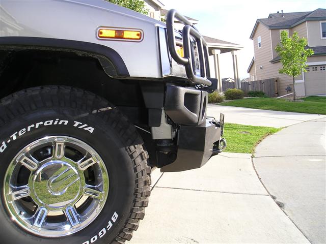

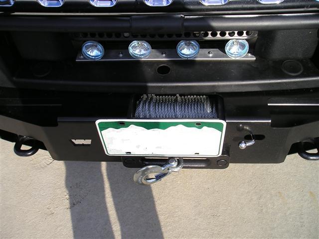

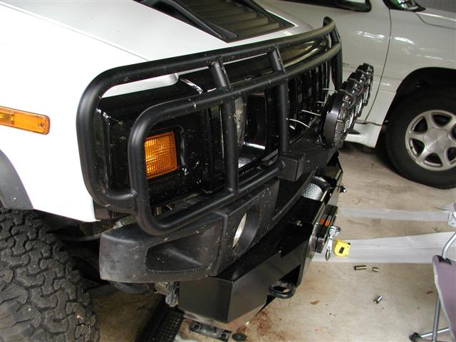

Paragon, I had the same problem with the bolts not going in straight.
However, thanks to Gobi for their help, We re-threaded two bolts and I'm done. I made two ABS Plastic guards to go over the bumper too. so when you take the winch cable hook to your tow hook, it won't be scratched over and over again. as for the POS cable being to short, their is a red box to the left of the battery and down further. I just an the POS cable to that... it reached just barely.
Overall, the project took me from 10:30 til 4:30 with an hour and a half brake becasue it rained and all of mt tools and trcuk were outdoors.
So here are some half-a$$es pics of the final job.
Overall it wasn't a bad project and am happy to answer an Q's anyone has on the installation.
Thanks Fever for the great deal and all of your follow through on this.

timgco, I like those extra lights! Q: Why don't you just cut out circles, instead of chopping off the trim?
Can BLING Get You Home?
  #39
Old 09-26-2004, 12:12 AM
<BLOCKQUOTE class="ip-ubbcode-quote"><font size="-1">quote:</font><HR>Originally posted by H2Finally:
timgco, I like those extra lights! Q: Why don't you just cut out circles, instead of chopping off the trim? <HR></BLOCKQUOTE>
Tried that at first. when you open the hood, their toast. So that is what I ended up with. I have to pick up my powder coated bracket yet and put that on. All Black. I want to do something with the Bling grille too.. not sure what to do yet on that.
