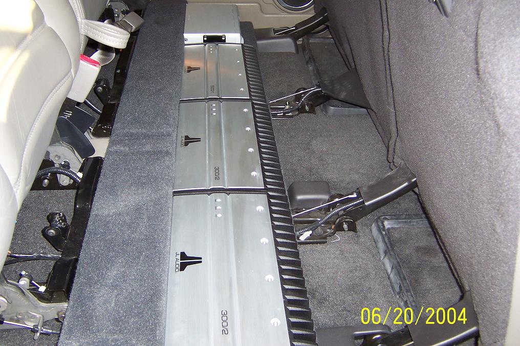

This is my amp rack.

Nice, does it precluse you from laying the seats down flat?

Preclude....

Yes they are at an angle but I never really need the extra room inside as I have the GOBI Rack.
