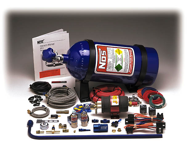

BTW, here is your answer. Go with the SC or single turbo setup. Then add a small 50-100 hp shot of this (I know I want to): http://www.holley.com/HiOctn/ProdLin...NOSNS/GM2.html (That may not be the exact part number)
