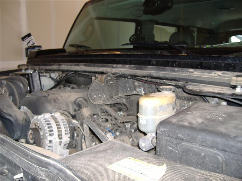

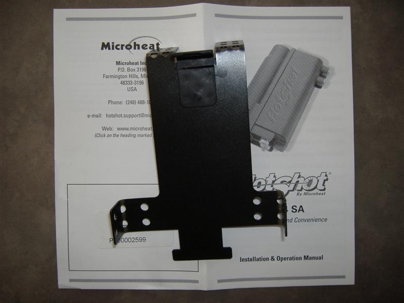

Bracket changes

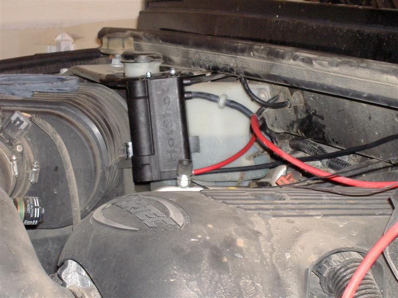

Splice into the line on the right...put two filters/whatever on...

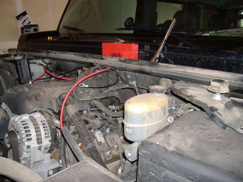

What a mess!

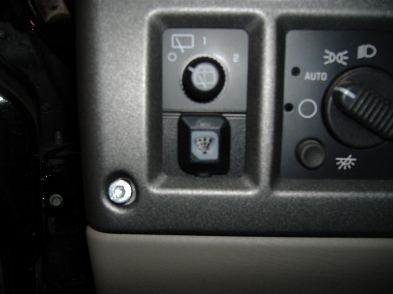

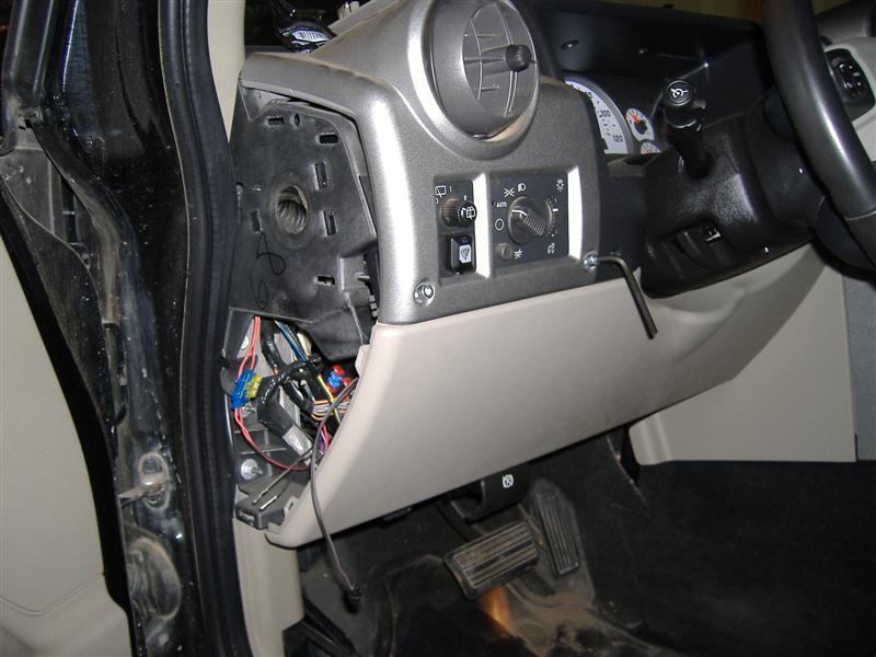

Wiring and location of button.... Not as bad as I thought it would look....

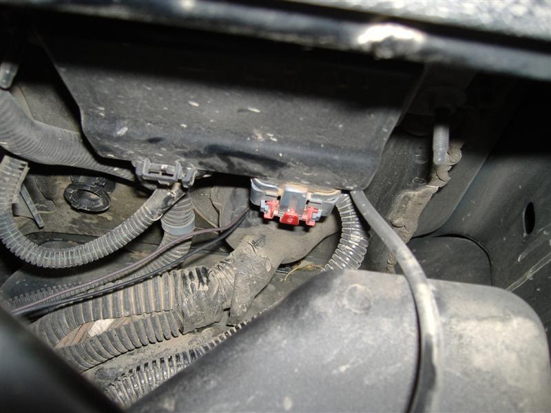

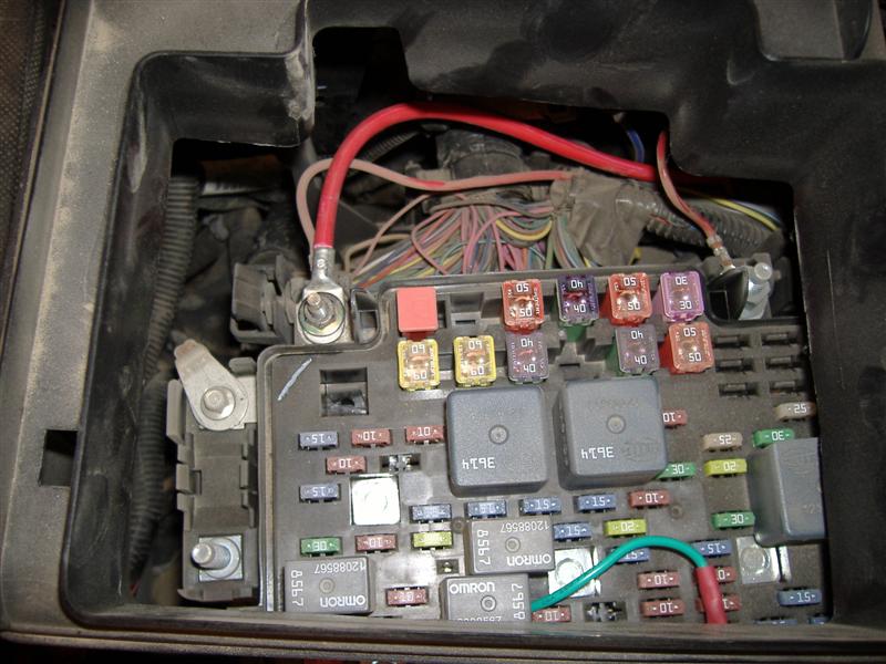

Ok, this is where I messed up... Don't do it the way it's pictured here. I tried the two posts on the top...didn't notice the second one had a 30amp fuse on it...so after blowing the first and second...finally attached it to the B+ post...the top one along the left side of the fuse box. This one has a 125amp? on it. Haven't blown that fuse yet...
Oh...anybody know where the fuse is for the left post on the top side of the fuse box? The right one was easy to see blown...but I don't know where the left one is...

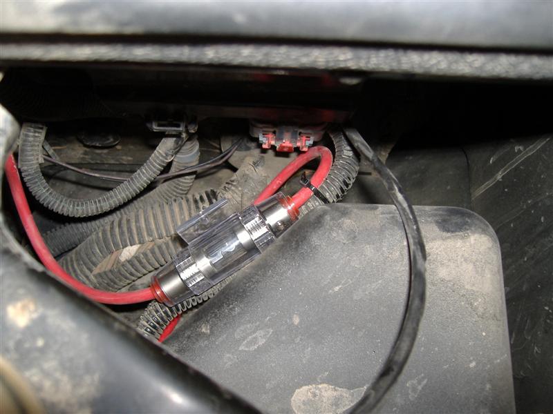

I was too lazy to "mount" the inline fuse for the hotshot...so I just tied it down...
