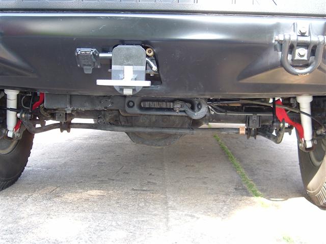

Here is where I mounted my air quick connect next to the hitch reciever. You are right about sand getting in there, I use a small screwdriver to depress the center plunger and blow the dirt out before hooking up the air hose. So far dirt hasn't been a problem (after about 8 months use), I do wash it with the pressure washer when I wash the H2 though and spray a little WD40 on it.
BTW departure angle isn't a problem as my winch fairlead hasn't hit, but notice the drag marks on the right "D" ring.

nice install.. I found that sand also gummed up the retractable part of the quick connect.. I dont wash my truck too often so that probably nailed me.
got any pics of underneath on how the winch is installed.. that looks pretty tight but dont know what you mounted to with ease without making some big mods...

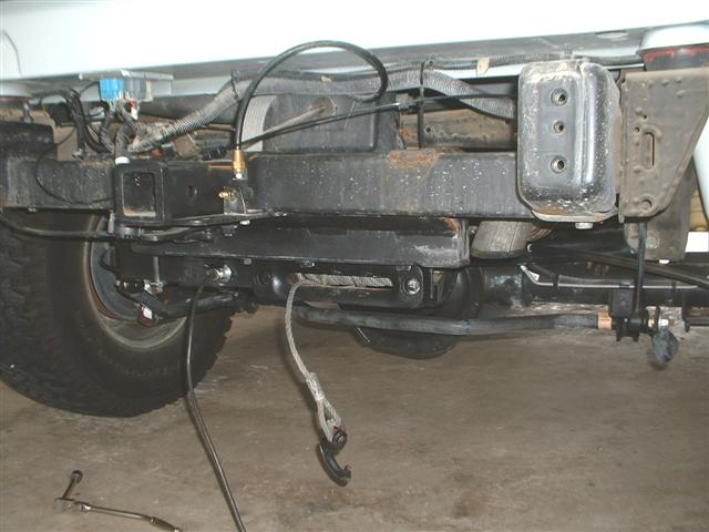

Yeah... it got pretty involved before I got through. That is a M8274 Warn which I already had and it has it's own dedicated battery mounted along side it. The power cables are only 18" long 2ga. so it does't experience much voltage drop during heavy pulls. I pulled battery charging voltage from the trailer recptacle. I built a whole new receiver and winch mount for the project.

here is a pic with the bumper removed, you can't see the winch or battery very well though.

that does look pretty involved.... for me... I will grab a friend and carry the winch to the rear... but if i were to do it all over again.... that would be pretty tight

And... how do you get to the clutch handle or untangle the line? Plus, isn't the Haas fairlead pretty exposed to rocks and, well, everything else? Have you considered putting a piece of 1/4" plate under it for protection?

<BLOCKQUOTE class="ip-ubbcode-quote"><font size="-1">quote:</font><HR> And... how do you get to the clutch handle or untangle the line? Plus, isn't the Haas fairlead pretty exposed to rocks and, well, everything else? <HR></BLOCKQUOTE>
The clutch handle is the lever directly under the reciever.
Haven't had much problem hitting the fairlead yet- thats not saying it won't happen though, but I do have some pretty deep drag marks under the rear axle differential and the rear "D" rings however.
<BLOCKQUOTE class="ip-ubbcode-quote"><font size="-1">quote:</font><HR> Have you considered putting a piece of 1/4" plate under it for protection?
<HR></BLOCKQUOTE>
Yes, I had a piece cut to weld in under the winch when I built it, but left it off because I figgured it would be too hard to untangle a pinched line. A piece of 1/4 X 2 flat bar directly under the fairlead would offer some protection for the fairlead however. I will have to put that one on my to-do list, shouldn't take very long- thanks.
