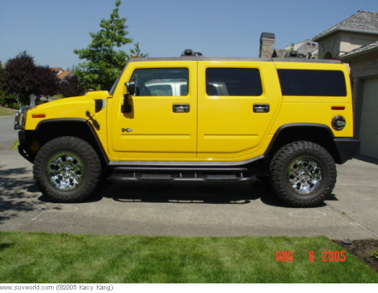

Anyway, I did come across McGaughy's spindles that would safely drop the front about 2 inches. The question is, will my 35/12.50-18 wheels rub? Any thoughts?
BTW - I only want to drop the front and the fender to tire "gap" is about 1.75 inches greater in the front of the truck so a 2" drop would just level it out. Not sure why but the gap does not look as bad in this pic.

Never mind, I bought a 18 MM socket and adjusted the torsion bars myself. It's level now.

Everything measures out at 8 inches now. I may go a tad lower in the front but I haven't decided. I'll send you a pic once I get back from Leavenworth. Did you make the torsion adjustment as well?

It is my firm belief that when an H2 is sitting perfectly level, the fender gap in the front is taller than the fender gap in the rear. It's made that way, whether the looks are appealiing or not.
I just wanted to throw that out there to avoid confusion about someone saying the truck is level, when in fact they mean the fender gaps are the same. IMO, they are mutually exclusive measurements.
