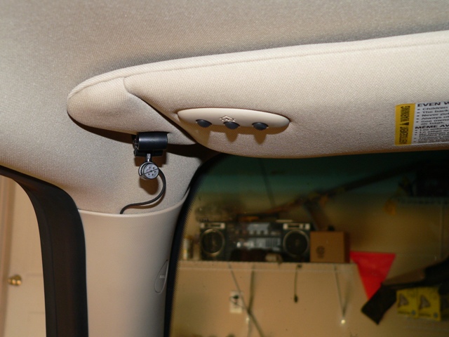

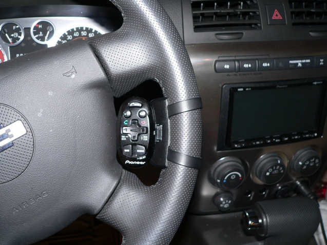

Here are some pics of the steering wheel remote and the microphone for the Voice recognition on the Z1

I put my mic on the bottom right in the intrument cluster by the speedo. I agree on the voice recognition. It works flawlessly.
Thanks for the pics on your steering wheel. My reason for lookin at the remote was for a trigger for the voice control. That might fit the bill.
