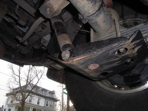

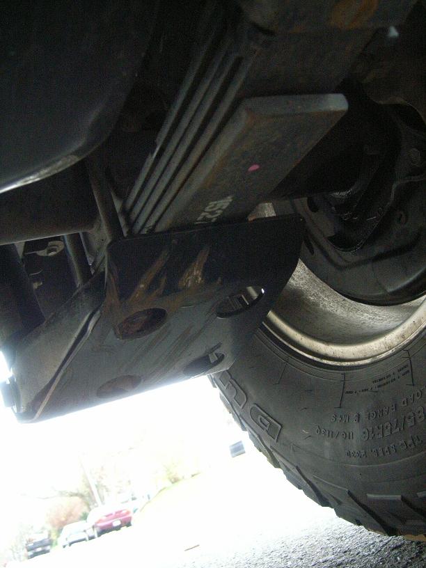

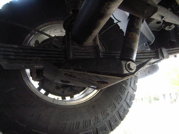

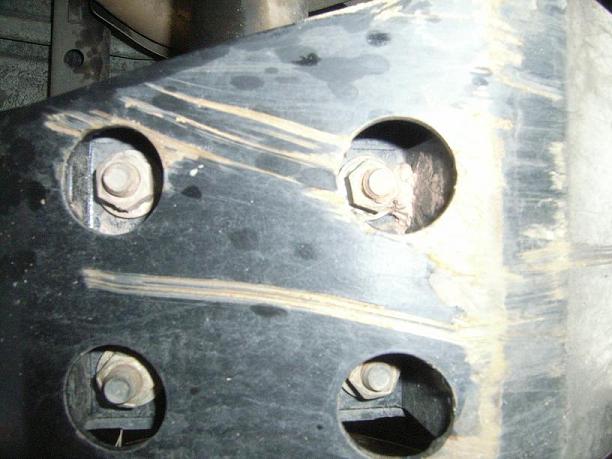

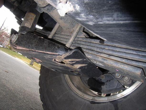

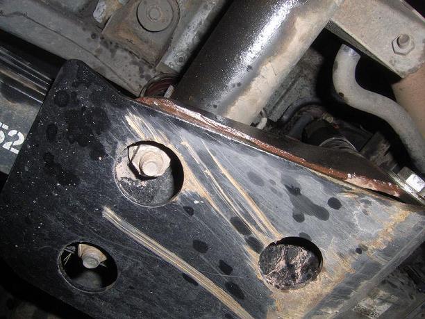

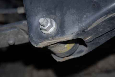

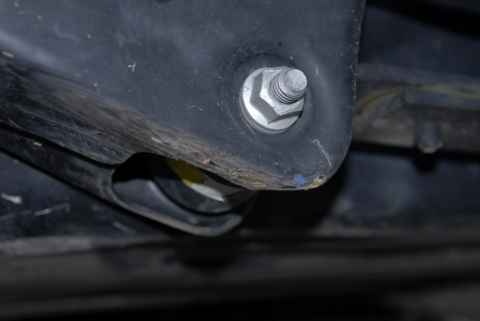

So here are my Amstar shock skids after their first trip off road. I'm glad I got them. When I picked up my truck from the dealer, Service was already closed so I didn't have a chance to ask the tech whether he actually replaced the hardware per the instructions...doesn't look to me like he did.

Default Re: Spring shackle skid plate

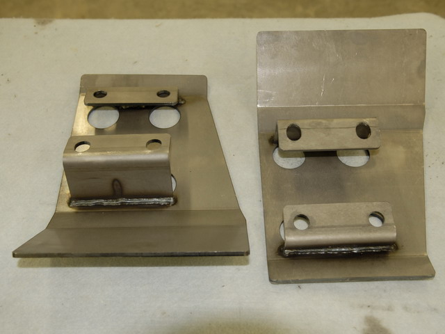

Yep you got battle scars just like me. Your pictures really show why the ones I made are an inch wider on the inside to protect that shock bolt head. Not that it could not be cut off if need be to replace it, but that might not be fun in the rocks or mud. We can live with this problem if we use the skid plates. The front hanger is also a problem. I smashed one of mine the day before I decided to get the pattern made for the front. This is part of the vehicle and can be fixed but will never look original. A plate up there will preserve the original mount.
The second image shows the driver side. They put the bolt in before the tank and its skid. So Im making my skid for that so it will just tack weld on. Any muffler shop would probably do it.
The delay has been a stand off of sorts about making me one set before comitting to 20. I think I have something worked out now. Between deer season and Holidays they are short handed at the fab shop.
I will post in classified as soon as I get some.

Hey BJC, I'd agree it looks like they reused the hardware and did not install new. I'd go back and givem' hell. Their suppose to know what they are doing.

Both sides

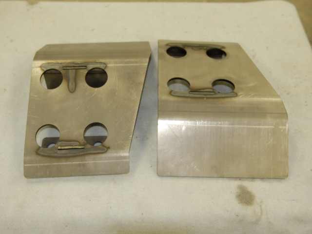

  #55
Old 02-06-2007, 01:49 AM
Hunner's Avatar
Hunner Hunner is offline
Location: Arkansas
Posts: 363

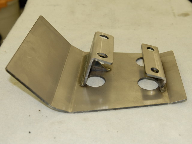

Top and bottom. This shows the laser cut index slot for strength. They will be welded here on the production run.
  #56
Old 02-06-2007, 01:51 AM
Hunner's Avatar
Location: Arkansas
Posts: 363

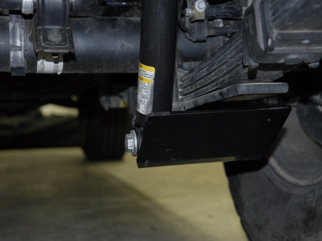

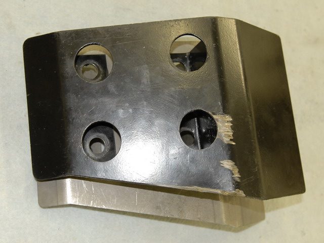

comparison to the "little one" that does not cover the shock bolt.

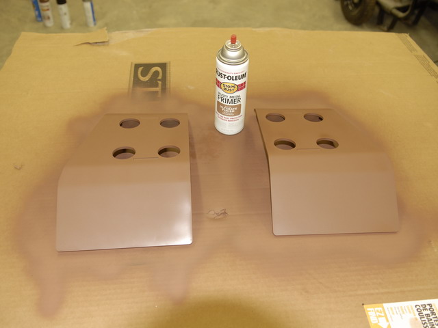

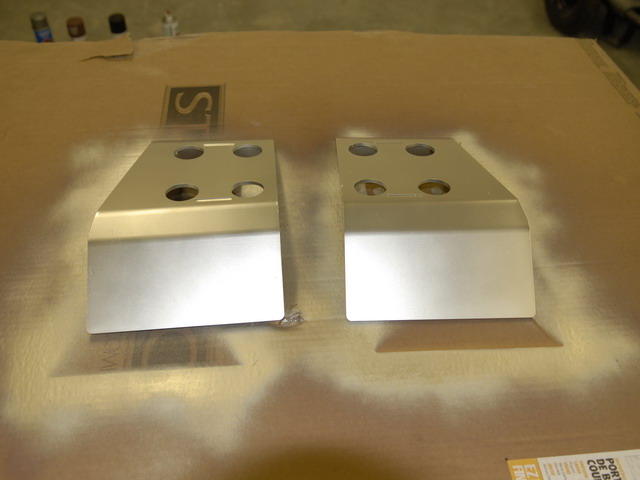

Primer, Im workin on it!

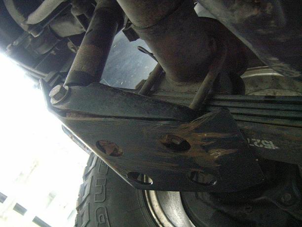

Next, I painted mine silver so they will show up in the installed photos.
  #59
Old 02-06-2007, 07:01 AM
Hunner's Avatar
Location: Arkansas
Posts: 363

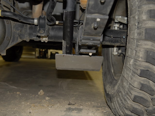

Installed! here is a before
  #60
Old 02-06-2007, 07:02 AM
Hunner's Avatar
Location: Arkansas
Posts: 363
here is after
