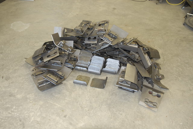

They say a pit-chure is worth a thousand words. Im not sure I know a thousand words anymore so here.
1secondwind@comcast.net
email your physical address to receive UPS ground
Cashier's check for $150 (I will send my address to those that reply)
I will send out to the guys that spoke up first and go till I run out.
Finally! Git-er-done slap um on. I will include some suggested procedures.

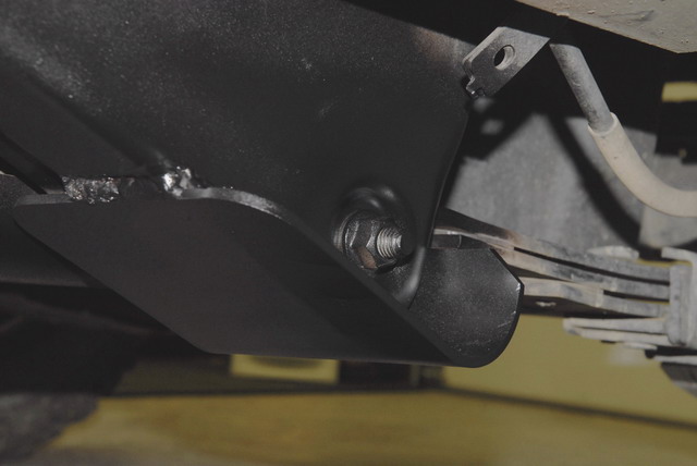

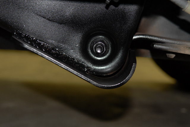

I welded my front ones on today and Im going out to test them in the outdoor lab.
03-02-2007, 05:34 AM
Location: Arkansas
Posts: 363
Re: Spring hanger/shock mount skid plate
They can be welded on the outside edge and front. I will see if I can tear one off. Ok I will quietly disappear now thanks.

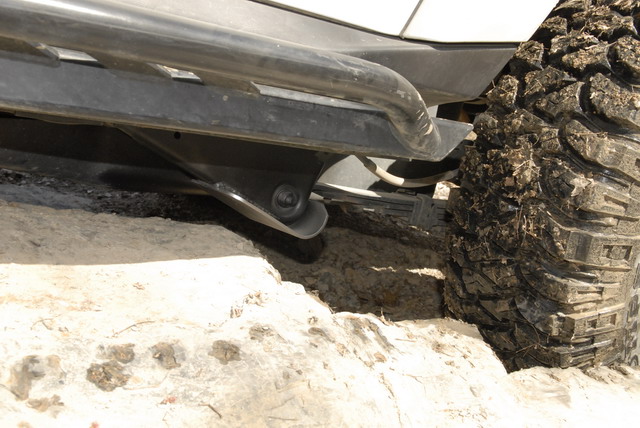

I found one oddity. The frame is high strength steel, a good thing. It really needs to be TIG welded. You can use MIG but have to really crank up the heat and do it in little bursts. It's a square wave queer ion polarity gey molecules thingy and there will also be an eclipse of the moon this weekend, Im not sure what that has to do with welding but I know it is an unatural act to hold a live wire between an endless power supply and ground!! Then squirt inert gases at the same time. DISCONNECT THE NEGATIVE BATTERY LEAD FIRST!
I just blinged my front ones with silver paint and Im running over to Superlift to shoot some pictures and do some field testing, I love my job!!
Did I mention DISCONNECT THE NEGATIVE BATTEY LEAD FIRST??

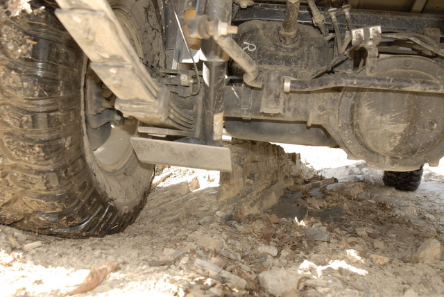

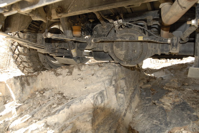

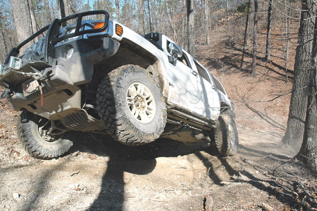

See all the testing I do. I usually try to miss these lines but here I am trying to be in the wrong place! ha ha I must go back tomorrow I need to guide so maybe I can lead some Jeeps thru here and see what happens.

I called my service manager for suggestions when I welded up my UCP, he said to disconnect the POSITIVE battery cable & let it sit for 15 minutes so the modules do an auto shut down. Don't bake your system!!!
