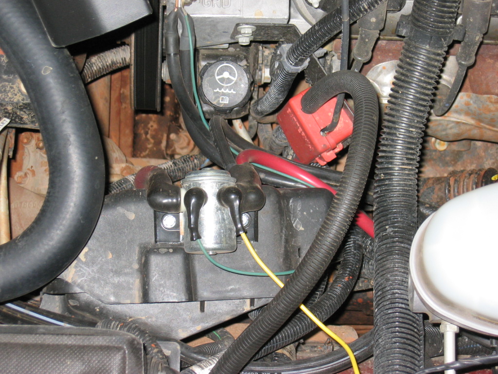

Which brings me to my real question. Where is every one mounting the solenoid I feel really stupid since I have searched this sight and appear to be the first person to ask this question. However, the walls of the engine bay around the battery is pretty full with factory equipment. Any suggestions or pictures would be greatly appreciated.

David,
You could mount it in any number of places. But, we decided to mount it underneath the black, metal "corner brace" plate on the driver's side. My son has my camera, or I would post a picture. It is tucked away, out-of-the-way, but also fairly close to the red box that we tapped for power. This is the same brace that you are supposed to remove in order to access the fusebox. So, it could potentially be a nuisance if you need to remove the fusebox cover often? But, after trying to figure out some preferable place, we settled on there.
Someone else might have an even better place.

Cincih2
I did not want to mess with my H2's electrical system so I had Warn winch system installed by the dealer. They mounted the solenoid on the plastic cover shield of the truck's computer. See photo. The switch was mounted in the overhead counsel. The switch location is convenient and look stock.
