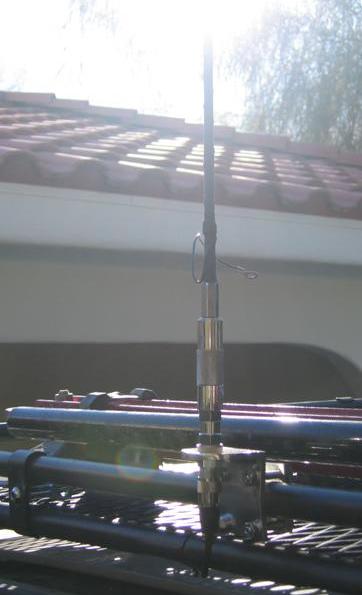

I was also guessing that it isn't making good contact when folded down. Hence the idea to directly wire the top portion to the stud.
I don't really expect it to work well when folded down, but I'd like to know that if I do transmit with it down accidentally, I'm not going to be damaging the radio. I'll just try not to do that

if it's folded down, you're reflecting your transmit signal off the roof and right back into the antenna. the swr is telling you how much reflected signal is coming back to your transmitter. a swr reading of 1.0 is perfect, and hardly achieved. most standard commercial broadcasters shoot for a reading of 1.5 or better. anytime you broadcast with your antenna folded flat, you're going to be reflecting that signal back into your transmitter. it's not good for it, but a lot of today's cbs are pretty bulletproof, it shouldn't hurt it unless you keep the transmitter keyed for a long time. it will work better if you put it up though.

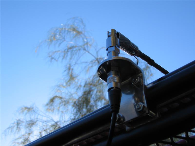

Thanks again, Dick. I'll snip the matching wire, leave the tuning alone and seal the connections. I have a good supply of PlastiDip -- it's a favorite tool, so to speak.

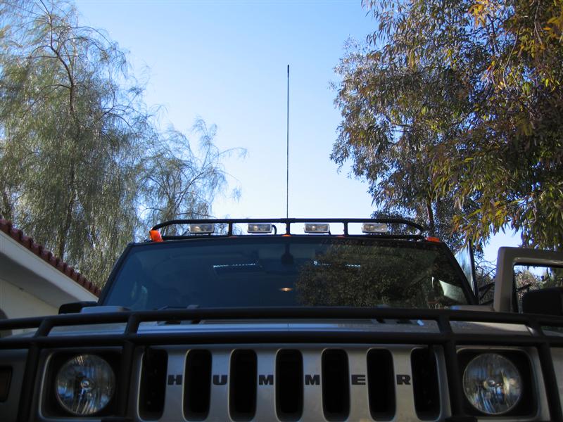

Antenna ...
\'05 SUT

I'll take pics later. The dash is still in pieces.
Not sure at this point if I'm going to do any tuning. Thoughts? </div></BLOCKQUOTE>
Considering that it is mounted on the rack and the best match you can get with a solid roof mount is 1 to 1, I would leave it alone and be greatful. Great job and it looks great to.

Antenna folded. Still have to decide what to do with the matching wire. Directions say it's only necessary if SWR won't go sub 2.1. Suggestions?

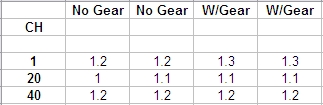

Thanks! I'm pretty pleased right now.
Tested two more times with no gear, then two times with. Still have done no tuning.
Tested two more times with no gear, then two times with. Still have done no tuning. </div></BLOCKQUOTE>
Those numbers look great! Nice job!!
