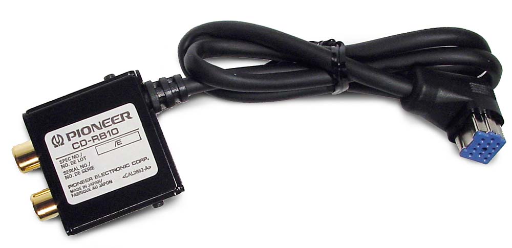

1-PIOGM1 from Soundscape ($145 yikes)
2-IP bus to RCA adapter from Pioneer ($15)
3-Stereo RCA male to mini male (Radio Shack $8)
4-Belkin Cigarette lighter adapter for IPOD (40)
5-12 volt cigarette lighter (Pep Boys $8)
Pull the stereo bezel, head unit, gear shift, console cover, and console insert...
plug in #1 & #2 to the back of the stereo. That will give you stereo RCA female. Plug in #3 into those RCA females.
Make a hole in the insert for the lighter. Tap off one of the 12 volts indash to power the lighter.
Plug the Belkin piece into your new lighter. The plug from the Belkin goes into the botom of the IPOD (same connector as the IPOD cradle has). The Belkin also has a mini input, and volume control. Plug in the mini from #3, turn up the volume, and you're set.
