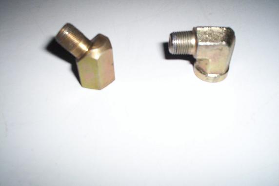

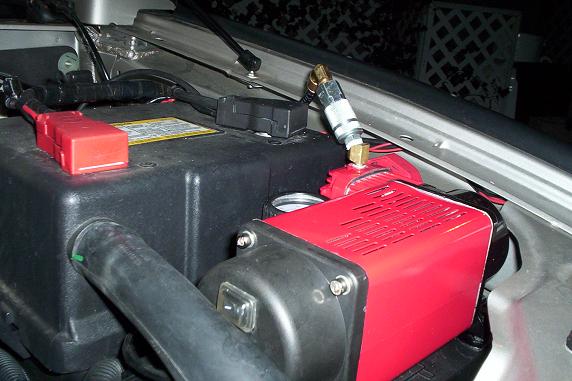

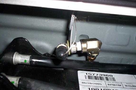

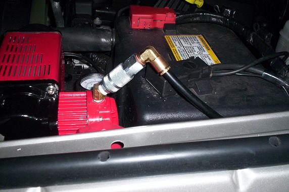

I started install I used a 45 deg fitting off compressor to a male with biger threads to female fitting to 90 deg to my hard hose.I have about 1/2 inch clearance to hood.I used the male that came with compressor on frame and mounted to factory bracket on frame I just have to add an adapter to it to hook up hard hose.I will finish tommorrow because it got dark.
I have a small thread fitting in 90 deg and 45 deg left ofer they except a small fitting like the male that comes with compessor. it might work for you (JP) last pic is of those fittings.
The 45 deg I used off compressor has a larger thead size on the one side to except the male fitting I used.
Ill post more tommorow.
  #62
Old 03-11-2006, 10:30 PM
fourfourto's Avatar
side view

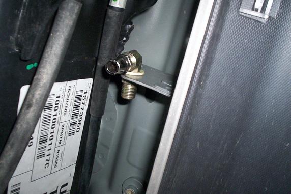

  #63
Old 03-11-2006, 10:31 PM
fourfourto's Avatar
Fittings on frame I used existing hole in bracket off frame.
  #64
Old 03-11-2006, 10:35 PM
fourfourto's Avatar
The extra fittings a 45 deg and a 90 deg .JP the one side is same threads on compressor and other side is same as male threads (the one that came with compressor.If you think you cane use them e mail me or pm me your address.My email is fourfourto@yahoo.com I think its listed also on my profile.

  #66
Old 03-11-2006, 11:44 PM
Looks good 442! You guys did a nice job on the install!
  #67
Old 03-12-2006, 04:36 PM
fourfourto's Avatar
Finished up works great.
I used a rubber end to protect male fitting at frame.So not to lose it when airing up I used some strong dental floss attached a small button put a little silicone on the end,then I used a needle through tip from the unside and thread it through.Then tied it to bracket above.
Jp Its no trouble sending you those fittings I had to use 45 deg because I needed small thread on one side larger on other side.The ones I have are small and small it should work for your fittings.Im not sure if the 90 deg will work because of battery location.either way you can leave hose hooked up 24/7.

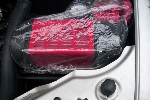

fourfourto's Avatar
Then my wife told me we have a few shower caps(from hotels/casinos) so I stored one in the truck.I figured when I air down I will put shower cap over compressor.

Old 03-12-2006, 04:42 PM
fourfourto's Avatar
I also noticed I forgot to rotate housing for better venting.Then I thought it might be a good ideas to leave it with a vent on bottom to drain water if it gets wet.6 of one half dozen of the other.

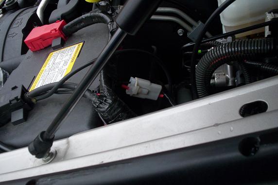

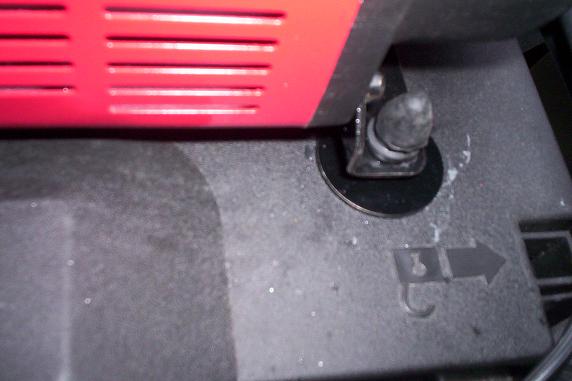

I siliconed a washer(notice I painted hardware black) were the forth mounting hole would be and used a gromit that came with compressor(Note: you must push gromit up to lower notch for proper height)
  #70
Old 03-12-2006, 04:44 PM
fourfourto's Avatar
And I used a disconect on the power wires for quick removal.

Posts: 1,204
Those look great guys. One question for fourfourto, You lost me with the shower cap. Is this just to keep it dry when going offroad? How long does it take to fill a tire? Thanks. (I guess thats two questions )

  #73
Old 03-12-2006, 07:16 PM
fourfourto's Avatar
I seen some pics of the engine compartment that were very muddy when water forging and muddin. so In those situations ill cover to protect from water and mud.
As for fill up time I havent timed it but JP did .and anwered on another post .His answer was

  #74
Old 03-12-2006, 09:28 PM
"Compressor Condom".....Looks great!

  #79
Old 03-15-2006, 12:01 PM
fourfourto's Avatar
With the large washers there shouldnt be a problem with the cover holding up.But when removing cover at below freezing you must be carefull not to brake the clips.Even without the compressor on it.It would be a good Idea to warm up engine before removing cover in the cold temperatures.The cover is only $18.50 at the dealer.
The compressor is only about 8 lbs and there is no need to remove cover from fuse box under normal conditions.
