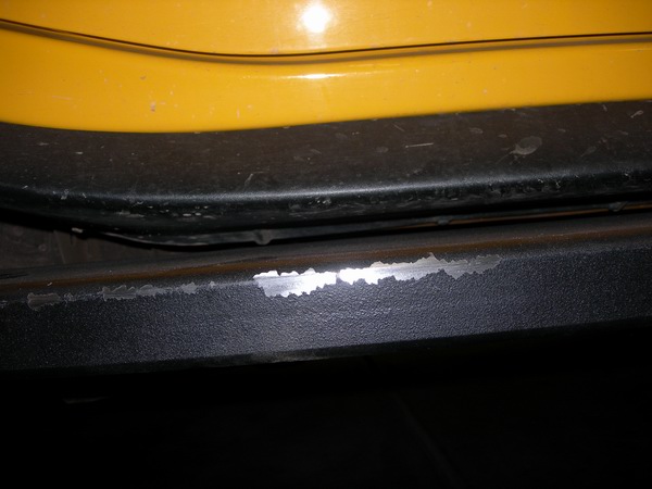

Tell me about it Mark! I used that crappy Duplicolor crap (PARAGON was right). The other night I pull my snowblower out and very light scraped against my rails. You can see what happened. I'm either going to paint them with that Rustoleum flat black industrial stuff (great paint). Or, I may have them powdercoated. I'm probably gonna see how they hold up before I invest in powder coating.

Powdercoating is worthless for rock rails if you are going to be using the rails for what they are made for. It's way too much money to get it done for something that will get scratched through to the metal the first time you hit the trail. It would be OK if it was for something else, but I've found the Rustoleum stuff to be durable enough not to flake off and very easy to touch out without it looking like you touched it up.
It's next to impossible to touch up the powdercoating and have it look decent.

Yah. That rustoleum industrial stuff is excellent. I use it on almost everything I make from metal. It's hard-core durable. I like how powdercoating holds up, even on the factory rails. But it will be a lot of $$, pretty much doubling the cost of the rails.
OK....I've talked myself into the Rustoleum.
