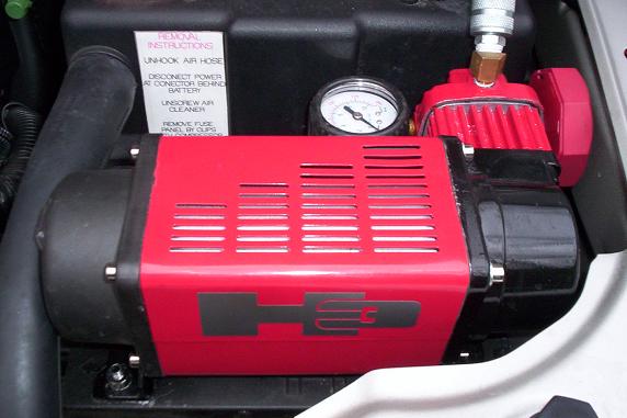

Yeh . To remove you must unscrew air cleaner.

Yes, a bit of a prob!
I take The filter off and am able to get my hand (with a little effort) in there to get at the clips. (I have long fingers!)

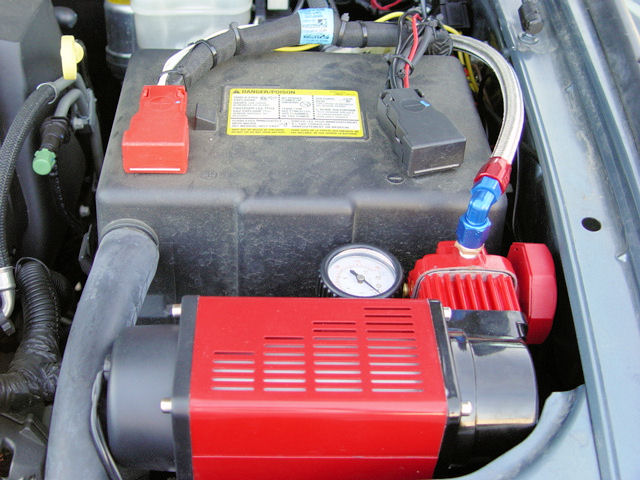

Jeff make sure you dont drill the 4th hole in the fusebox cover.
And buy a quick connect at radio shack for the power wire.
Are you going to run a line to the frame or are you just going off the compressor with the airhose ?.
Definately no fourth hole!! I'm going to run a line to the frame. Is there any one place better to come out with the air, such as the side, front rear, etc.? I'm also planning to swith it from inside the truck so the hood doesn't need to be popped for anything.

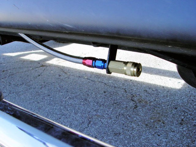

Look through this thread there are pics of side install.
You could run the air hose down along the drivers side frame rail and run a splitter off of that to the drivers side. I'm thinking of doing that myself! as for that fourth hole one the fuse box cover, GO FOR IT, It adds character!

I got mine installed this afternoon. I used a relay and switched it inside the cab. It's a nice compact install. I appreciate the info.
Jeff

Pics of my install:

Nice set up Jeff!
Can you give a little info on the fittings / steel braided hosing from the pump to the coupling mounted on the frame rail?
Thanks!
