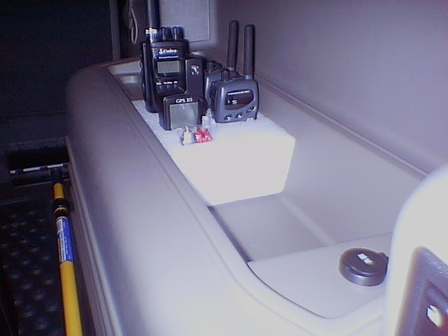

Mounted in here is a Cobra HH38 WX ST hand held 40 channel CB radio with 10 weather bands, DC power cord for the CB, 2 motoraolla FRS radios, a Magellan 315 hand held GPS and a 48 pack of AA batteries to run everything.

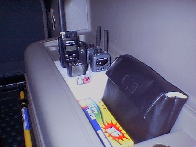

Another shot

Actually that is permanent. It is made out of 3-1 inch thick sheets of plastic type foam, not styrofoam. It is almost impossible to rip and it doesn't shed like styrofoam. It has an adhesive back so I cut three sheets to size and stuck them together. When I cut the outer dimensions, I cut it "fat" and pushed it into place. You would be hard pressed to pull it out. I then traced the bases of the 4 units on to the top where I wanted them and then cut down into it 2 layers so there is still a layer on the bottom. I cut the cut-outs tight so you have to push the units in. They don't move at all, very snug fit. And I haven't heard a peep out of any of them yet!

This stuff is very "grippy" and very dense. It is the newer stuff that they pack around electronic devises. I've seen it used in as packing around computers, printers and most recently around a sub amp that I bought my son for Christmas. It is very durable, however easy to cut with a sharp knife. I've seen this same stuff come in different colors, so the stuff you talking about may be the same thing. Also as I said earlier I cut the outer dimensions "fat" and when I pushed it down into the well it locked itself in.

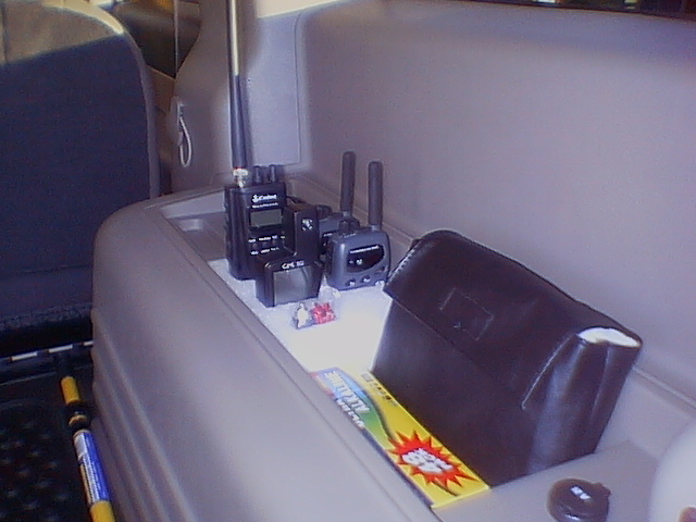

Here is another shot with the batteries and compressor hose out of the way. Also notice the cut is tapered in to conform to the shape of the well. I did this by sticking all three sheets together first and then cutting through all 3 layers to make it fit. I only made it so it took up one half of the well, this way I still had room for the air hose and the 48 pack of batteries. You can however make it to fill the entire well if you have that many devices to secure.

Actually there is a foam distributer/manufacturer nearby. I stopped in one day and told the guy what I wanted to do and he suggested this stuff. Check your local yellow pages for foam distributors, if you can't find one nearby I can get you the phone number. They are located in NJ.

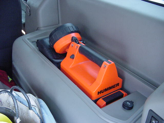

Thats good use of the storage tray. I used mine for my rechargeable flashlight. I took the power from the 12V plug. People always ask if thats a Hummer accessory

Nice hummer Light, although a bit big.. I keep a rechargeable Surefire light. It is brighter then the hummer light and about a 10th the size.. Leaves more room for more stuff.
Keep the balance of emergency equipment in med. size Pelican case. Wonder is anyone makes a replacement cover for the area behind where the spare used to be

It does take up some room, but the battery lasts a long time. (Not as long as an LED light ) I used this light because it was free and fire department issued.
