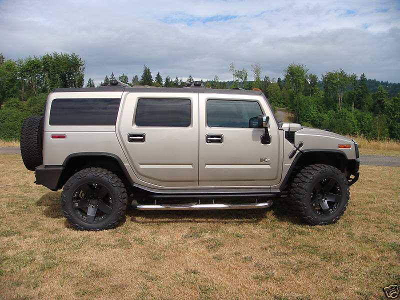

Please advise! I bought 20x10 rockstars and I need to keep my stock height so I'm sticking with the 35's on 20x10 rims but I need to know if I can get 13.5 width tires on it? I'm thinking bf km2's or Mickey thompson Baja claw
Here's the look i'm going for.

Yes, they will fit perfectly with no rubbing, if you get the right backspacing. You will need 4.25-4.75" backspacing 4.5" is perfect with those tires.

He'll yeah.. I'll take it. Did you by chance try them in the snow? I heard they were pretty bad but who knows.. The wheels that I bought are a 20x10 rockstars with a -24 offset. Not sure what back spacing they are? I think they are 4.5" I didn't realize that they came with a different backspacing option?..

18's with 35's worked for me ona couple trucks without issue.
20's on 37 woudl be great too IMO.
20's on 35's may be a little too low profile for airing way down. But if you hit one of those rims they are super easy to touch up. I had those on my last H2. 35 12.50 18 toyo mt on 18 x 9. 5"bs. no rubbing at all, no hitting that rear air susp sensor either. SO, with a 10" wide rim, and 4.75 you should be good. you can always do that rear air susp sensor mod where you flip it the back side of the arm to make a little more room.

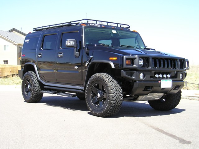

Old 11-10-2009, 05:25 PM
Synn's Avatar
Synn Synn is offline
Location: Toronto Ontario
Posts: 47
Synn is off the scale
Default Re: Will a 35x13.5 on 20x10 rims fit on a stock sut w/ airride
timgco vbmenu_register("postmenu_501051", true);
is this pic your truck ! And what are the rim and tire size on it the way it is ...Please
