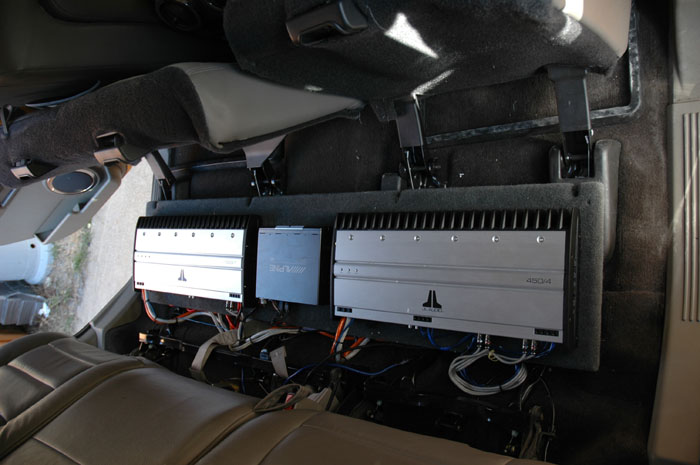

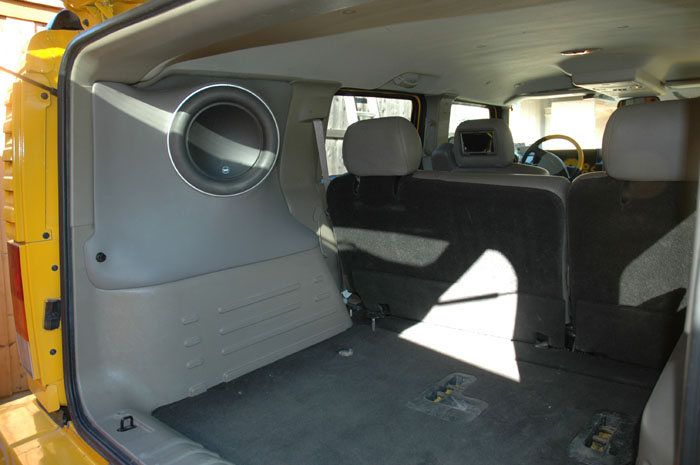

I changed mine out to MB Quart PCE-216's, added a JL Audio 450/4 amp. You will not be totally happy unless you upgrade the sub as well. The sub is what truly makes the difference in the upgraded sound, I went with a JL Audio 12w7 sub and a JL Audio 1000/1 amp, in a custom sub box to clear up some room in the rear cargo area. My set up is probably a little overkill for most but it does sound marvelous.

amps

Default Re: New speakers for h2?????????????
I really like that panel that's mounted in the back... How much for something like that?? It's soooo f'in clean looking!
g
g
$900, it was painful to pay for but well worth the cost.

been considering doing a similar ub enclosure in rear windows..
however, got a sill question. What did the installers do to keep the box up and not move around? Basically, what keeps it from falling down?

Sub box was mounted to spare tire rack supports. (see bolts)
