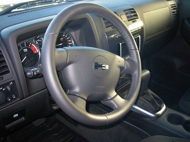

Default Re: Onstar Red Light
Leather Lux version of H3 steering wheel was approx 150 dollars from GM parts direct (part number - 15793345). I really like the new wheel! Simple swap out, except maybe it makes the Onstar red light come on?
Have you discovered what the problem was yet?
Also do you have a picture of the steering wheel you have, I went to the website but there was no picture or even a description.

Now for the rest of the story....
So, the other night I swapped out the plastic steering wheel for the leather Lux version. I pulled the SIR and HORN fuse before starting. I put the new wheel on and replaced the fuses. I noticed that the Onstar light was on (what I didn't notice was the airbag light was on, too. For the next several days I rode my old school Yeti everywhere since the weather finally got nice. Tonight, I finally got a chance to take a look a the H3.... When I was buttoning up the leather wheel swap, a friend of mine stopped by with some parts and a couple six packs. We did some work on his Defender in the driveway, had a few beers, and I remembered I hadn't put the fuses back in from the wheel swap. So, I did so on my way in for the night. Turns out I put the SIR fuse in the wrong open fuse slot (the slot I put it into was marked Spare-4). I just pulled the fuse and put it in the correct slot. And, what do you know - my Onstar is working and the airbag light is off. Hopefully I'll put my new torsion bars in the correct holes this weekend... no beers until afterwards. Let the flaming begin!!
By the way, the leather wheel was worth the 150. It is not as "thick" as the plastic wheel, and feels nicer in my hands (girlfriend just said not to say "feels nicer in my hands" on the Elcova forum, for fear of reprisal). LOL.
