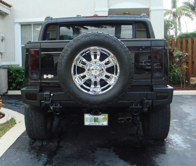

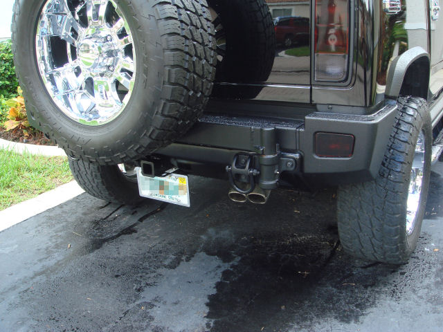

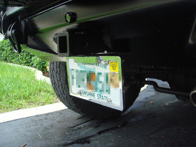

I put mine under the receiver. Used some aluminum L stock and a lighted billet frame. Cost around $20. Didnt want to drill the bumper or have it hanging off the side like some kits I've seen.
I would tear that thing right off my truck! It must be a pavement queen (no insult intended).
Nice rims, though! I bet it looks killer from the side view. Can you post a pic of the side and front? I'd love to see it!
Looks good, however I would certainly crush or lose my plate if I mounted there as I have already bent the spare tire carrier on a few obsticles off road.
Thanks for the reply and pics though!

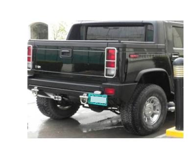

Here's mine. If you are interested, I'll give you the low-down. Sorry for the crappy cell phone pic.
How did you do that? Pretty cool.
Old 10-26-2007, 05:05 AM
tower's Avatar
tower tower is offline
Location: Westwwod, CA.
Posts: 2,501
Default Re: 06' H2 Rear License Plate Relocation
A little JB Weld. 3 very small angle brackets. 3 threaded Rivnuts (=Threadserts) and the SMA half-moon replacement billet. A little wiring a little cable & 2 swages. 3 small holes drilled in the wheel cover.
