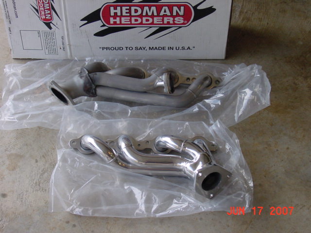

The dirvers side is brand new, and the passenger side is used.
I bought them new, but there was a leak in one of the welds on the passenger side collector. The weld has been corrected/re-welded. New, they were coated with "Jet Hot" High Temp Ceramic Coating. However, the re-welding process on the passenger side header has caused the ceramic coating to flake off in the collector area on this header only.
Hedman ended up sending me a new set and I ended up only replacing the passenger side, so that's why the driver's side that is included is brand new.
All bolts and hardware is included, but you will need standard header gaskets.
Jet Hot will re-coat this one header for about $75 plus shipping.
Ceramic coated headers run about $500-600 new, so here is a good chance to pick up a set that will be brand new if you choose to re-coat the single header. There is only about 50-75 miles on the one used header.
After install, I noticed a nice increase in throttle response and mid-top end performance. It also enhanced the sound of my exhaust with a more robust note.
These bolt right up to you stock-style exhaust flanges and are easy to install yourself by quickly removing the plastic fender well on each side of each wheel well to gain access to the bolts.

pic
