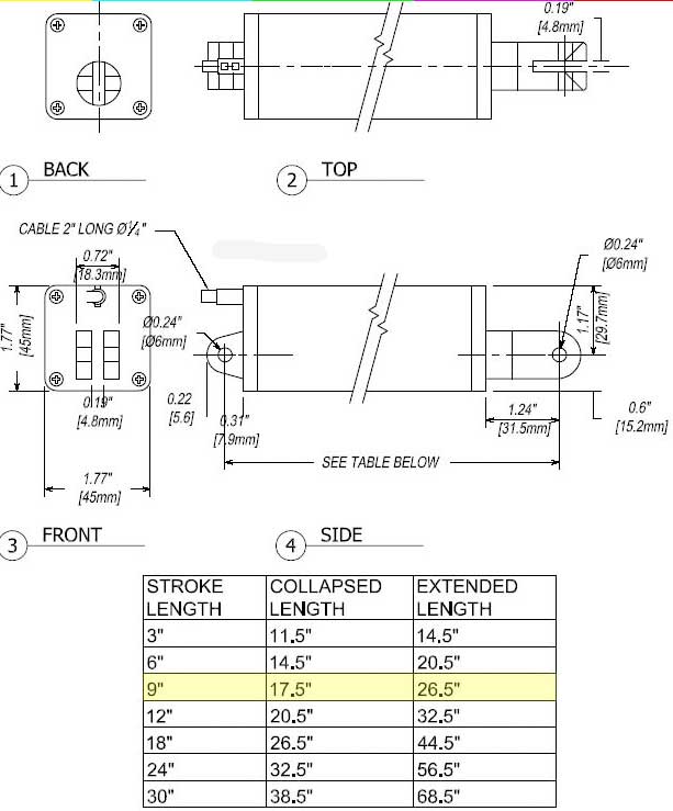

I finally got around to measuring the struts today. It looks like when fully open, the exposed rod measures around 7.25". So I'm thinking an 8" actuator should get it (you can set a limit on the extension). I didn't measure how much is exposed when the door is shut, but I'm thinking it must be less than 2" (the next size down is 6"). I will measure when closed anon. The 24" linear actuator has an 800 lb. pull. The shorter ones are 300 lbs. I'm guessing 300 will be enough. But I'm thinking I will need a second actuator built inside of the door to mimic the pulling out of the external door handle from inside the door. That could really complicate things. (It's either that or remove the latch completely which raises all sorts of liability issues should something or someone fall out the back while on the road.) Any input from you will be greatly appreciated.

I spoke with one of the manufacturers today. I was wrong, the shorter actuator is rated @ 250 lbs. I asked if only having one on one side would torque the liftgate and he said it might be best to go with 2 (one on each side). I don't know if that's true or if he just wants to sell me a second (expensive) actuator. For the door latch, he said I could probably use a less expensive (lower mass capacity) actuator, but that I needed to feel how much push was needed to trigger the latch. I guess I'll need to tear open the door skin and find out. He also sent me a spec sheet for the actuator. I need to see if the width will fit into the gas strut cavity. TBC...

I think I have my hardware selected. A remeasure will comfirm. Please click on photo for more information.

Very good info tower!!!!!! I agree with going for 2 acuator arms. It is a little costly but, you get out of what you put in to it.
I do not see anything to add to what you have come up with. When you get it all dialed in and tests done I would be grateful for parts list and wiring diagram. I think this option would be of good use to anyone.
