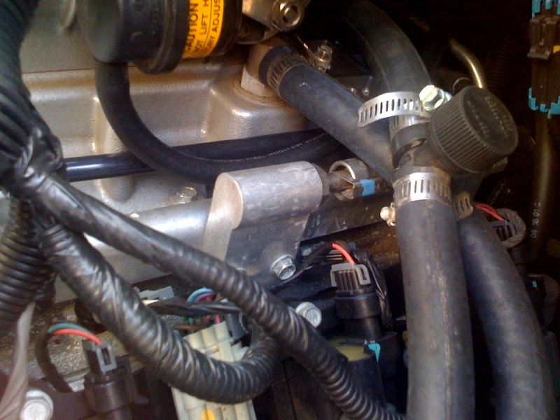

I'm trying to install a supercharger on my '06 SUT. The supercharger is used and coming off an '03 SUV.
The '03 uses a fuel return line with a regulator in the fuel block that attaches to the driver's side fuel rail.
The '06 DOES NOT use a fuel regulator (well it does, but it's in the fuel tank) and DOES NOT have a return line.
Is there anyone with an '06 H2 with a supercharger that could take a pic of where the fuel line attaches to the fuel regulator so I know what I'm suppose to have?
You shouldn't have to do anything but open your hood and snap a pic.

Hope this helps.

Man, does it ever.... THANKS SO MUCH.
Yup, I see the problem. The fuel block is different on a fuel system without a return line and regulator.
I wonder if I can buy just that piece from Magnuson or do I have to buy the whole fuel rail from the dealer.
Guess I'll have to wait till Monday.
As an update, the supercharger is installed, most of the wires are run. I just need to install the intercooler. (I'm debating on using the small one I had on my old supercharged H2 or buy a full size "H2" intercooler)
Anyone with a suggestion to the best place to buy an intercooler?
Other than that, I'm ready to roll. I did not this time change out radiators for an aluminum one.... I'm sure I'll end up doing so soon enough.
Mark

Mark,
The fuel block is available from Magnuson for a fairly low price (less than $50 if I remember correctly), the exact cost I don't remeber but I checked earlier this year when a buddy was considering buying a used setup for his H2 and needed the block and the 42# injectors.
http://www.frozenboost.com/index.php?cPath=217&osCsid=5e37fdaccc6d0c4cc463764 229b81287
With regard to the intercooler I have seen people use units from the link below good results.
On another note I had my radiator let go last month, which in turned smoked my transmission and made a mess I don't want to ever see again. Earlier this year the exact same thing happened to my dad's H2 that has the same supercharger setup. I now run an all aluminum unit and a larger external trans cooler bypassing the radiator with good results. I would ditch the factory Delphi radiator ASAP or at least bypass the trans cooler lines running through it.
Tom
