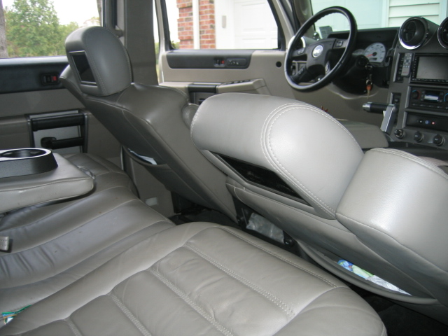

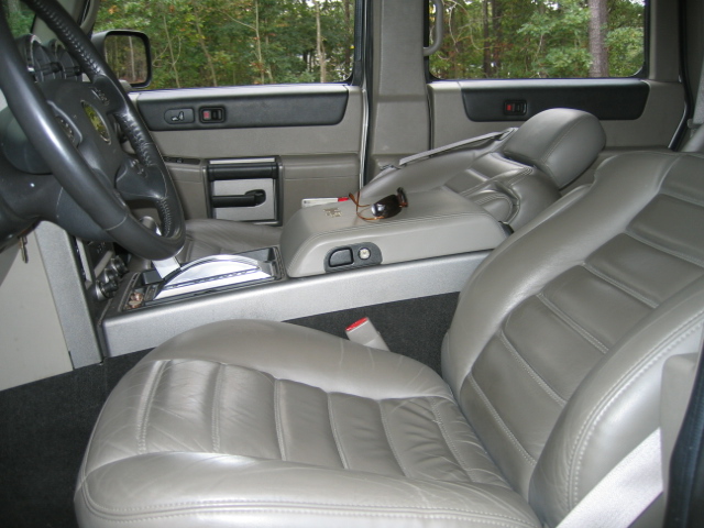

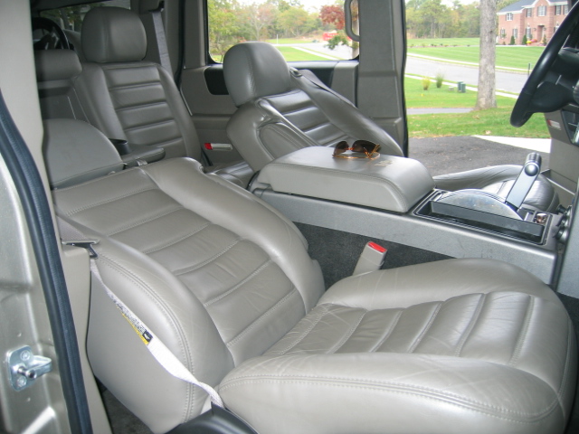

I did the mod today. Piece of cake
It helps to move the seat position up and down when re-installing the lower side seat covers.
Old 10-18-2007, 09:03 PM
NJ H2's Avatar
NJ H2 NJ H2 is offline
Location: Las Vegas
Posts: 1,819
Default Re: FULL RECLINE FRONT SEAT MOD
The passenger side goes down lowere than the drivers side
Old 10-18-2007, 09:04 PM
NJ H2's Avatar
Location: Las Vegas
Posts: 1,819
2
NJ H2's Avatar
Location: Las Vegas
Posts: 1,819
3
