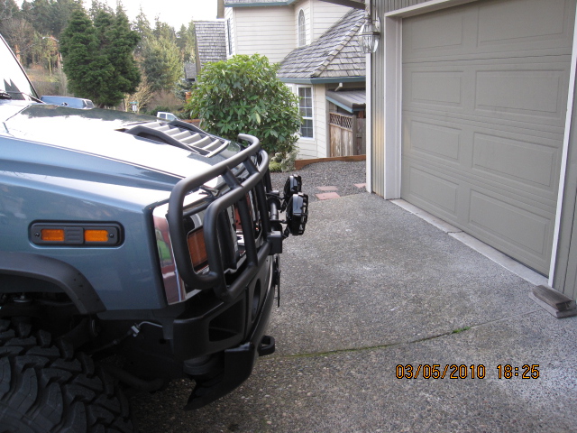

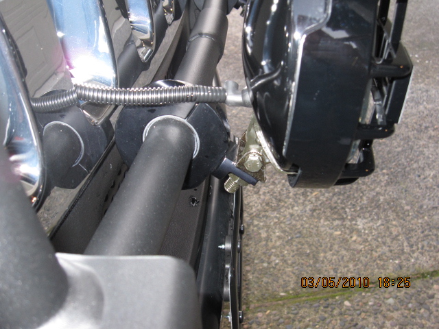

As far as your fogs, I think they stick out way too far. When I first mounted mine, they were in the same position. I turned my mounts around and was able to get them behind the protection of the brush bar. Don't know if you're able to do the same with your mounts. Let me know, I can post some pics of how I did mine.

Here is a couple more pics after I adjusted the mounts and aimed the properly.
I rotated the mount to bring the lights lower, which in turn means less downward angle needed to adjust the light beam properly, which in turn means closer to the brush guard.
I'd love to see your pics... as I think they still stick out to far.
You can say I told you so.. you were right! Pictures just don't display the light as it's seen in person. Regardless- the OEM or silverstar head light setup is horrible.
You can, for now, say you don't owe me a check. The first time I get flashed I'll be sending you my address! LOL
