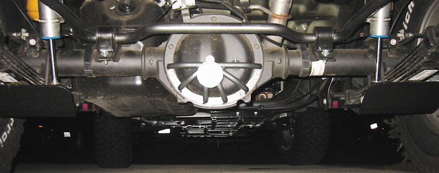

Stayed home tonight and turned wrenches. Spider Diff. Guard, Hunner Skids, Fox Shocks, Hellwig Sway Bar... and up front GM Undercarriage Protection. Tomorrow I'll go try it all out. Good night.

Diff Guard is from http://purplecranium.com/wsm/i-385_h...er_spider.html
Best 80 dollars I have spent, so far.
Here is a better pic? From this morning.

Nice protection. What's the deal with the beefy swaybar? (or maybe I should have paid more attention earlier)

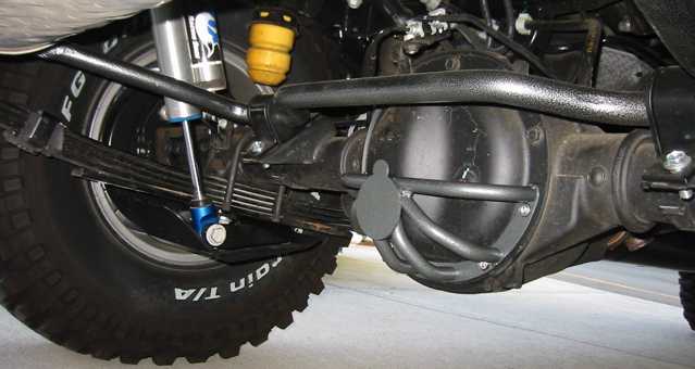

I dig my spider!
I've bounced that thing off more than a few big boulders. They are strong as hell. I've also read that they can help keep the the diff cover from flexing under heavy torque application.
Nice work under there, did you add disconnects for that bad ass sway bar?

My kid took the picture so it's out of focus, but you can get the idea.

I only have 3000 miles on my H3. So, I just removed the bottom 5 bolts and put the spider on there... no runs, no drips, no errors. I think the pumpkin cover is RTV'd at the factory.
The beefy Hellwig sway bar is 1 1/4 inch (some sales sites are calling it 1 1/8 inch, but it is 1 1/4). It came with poly bushings for the front sway bar, too. It makes a huge difference in the body roll I was experiencing in rear with the stock set up.
The only drawback is that I haven't gotten the parts together to make my own quick disconnects, yet. I really wanted the "orange" Amstar Disconnects (not because of the color, but because they are made for the H3 and look beefy), but who knows if they are every going to sell them. So, I am still deciding on which disconnects to modify. I am looking for this Ipe extend travel thread to see what he used. Anybody have any suggestions.
