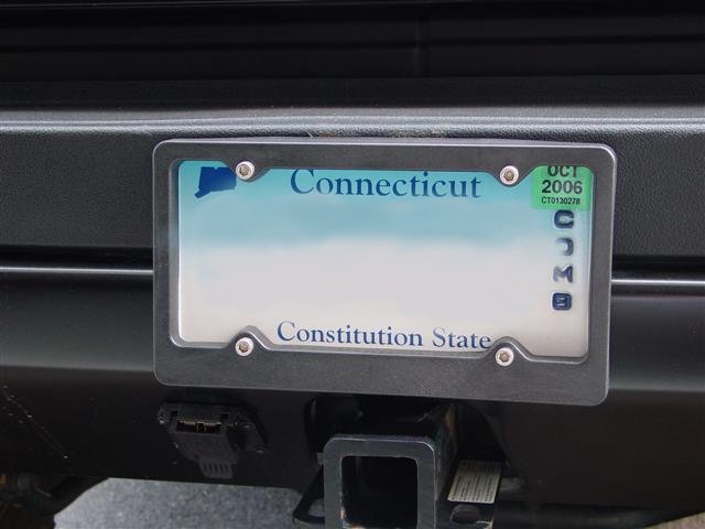

My DIY setup. Lighted plate frame & a few holes in the bumper.

would i still be able to mount it like that with a full size spare on, and still have the tag visible? it is a 37x 13.50 r18 grappler, im exteremly curious to know
Old 01-02-2006, 01:51 PM
TXSUT's Avatar
TXSUT TXSUT is offline
Location: Houston, TX
Posts: 1,290
Matt, no, it won't still be visible. One thing you might try is one of those hitch-mounted license plate holders (if you don't plan on using the hitch on a regular basis).

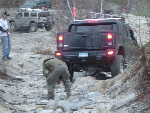

If you don't mind, what do the tow hooks end up looking like after you remove the tire carrier? Can you post a pic of the entire rear? I am curious as to how the wiring from the tirecarrier light works out as well...
Old 01-02-2006, 04:27 PM
Here's the best pic I have of Dan's truck. I'm sure if he sees this he'll get you a better one.

The tow hooks are integrated with the tire carrier hinge and latch, so you'll need to track down a set from an SUV that didn't come with a carrier. They're around, just ask.
The light wire has a bulb housing on the end that won't work so it gets cut off. I stuffed the wire back into the bumper and it now comes into the lighted plate frame from the back.
Let me know if you need any other info! I'll see if I can find a better pic of the whole bumper...
