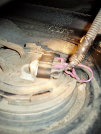

can someone tell me how to disconnect the electrical connection on top of the fuel sensors( i think...its the big connection on the top of the tank)?
it looks to be the biggest plug.

It's a single black plug, with a red connector on top. I'm still not seeing how to remove it.
I took some pics but they are too big to attach...I have no idea how to resize them. Jesus, I go from one problem to another.

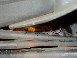

I think I got the pics attached.

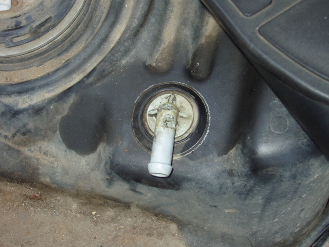

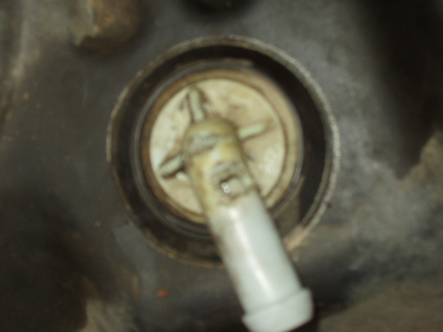

Thanks for the help Tim. The good news is I finally got the tank out. The bad news is I think I need a new tank.
I don't know of a cheap fix and these tanks look to be close to $1000. I've attached some pics of what I found.
I don't see where the elbow was rubbing on the body-no idea how it got so chewed up.
