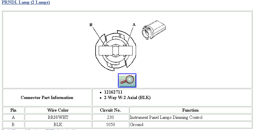

I have a Pioneer Nav System - Here is a small problem I have and wonder if you have it and how might it be corrected (Help Klaus):
The Pioneer Nav System has a Nighttime screen and Daytime screen - Day = Gray background (like your picture) Nighttime = Black background.
In the "Settings Mode" you can toggel the mode (automatic) which should allow the unit to change to black background when lights go on toward evening - however since the H2 has day-time running lights my backgroud is always black in auto mode.
Unless I toggel the setting to "off" - then the background is always gray even at night (which is to bright inside at night).
Have you experienced this - any suggestion? My Installer states that they cannot correct this problem.

<BLOCKQUOTE class="ip-ubbcode-quote"><font size="-1">quote:</font><HR>Originally posted by Tucson Beast:
Hi Frank
Thanks <HR></BLOCKQUOTE>
I don't have my wiring diagrams with me at work, and I'm guessing about the Pioneer, so here goes.
I suspect the Pioneer needs to be connected to a 12V source that is "hot" when the lights are on. If, in fact, the dash lights are always on, that won't work. I'd suggest a connection to the tail light circuit.
I'll look it up tonight for you.

<!DOCTYPE HTML PUBLIC "-//W3C//DTD HTML 4.0 Transitional//EN">
<HTML><HEAD><TITLE>Service Information</TITLE>
<META http-equiv=Content-Type content="text/html; charset=windows-1252">
<META content="Microsoft FrontPage 5.0" name=GENERATOR></HEAD>
<BODY bgColor=#ffffff>
<FORM name=topNavForm action=/servlets/CellHandler>
<TABLE width="100%" align=center>
<TBODY>
<TR>
<TD width="25%" slign="LEFT"></TD>
<TD align=middle width="50%">Document ID# 845475
2003 HUMMER
H2
</TD>
<TD align=right width="25%"></TD></TR></TBODY></TABLE>
<HR>
</FORM>
<H1>Interior Lighting Systems Description and Operation</H1><A
name=ss1-845475><A
href="http://127.0.0.1:9001/servlets/BlobShtml?ShtmlFile=845475&amp;evc=sm&amp;pubid=29 3&amp;cellId=53213&amp;mspsdsubkey=2305#ss1-845475">
<H5>Interior Lamps</A></H5>
The interior lighting consist of the following two groups. This first group
includes lamps that may not be dimmed.</P>
<UL type=BULLET>
<LI>Courtesy/Illuminated entry lamps
<LI>Dome lamps
<LI>I/P compartment lamp
<LI>Map lamps
<LI>Reading lamps
<LI>Vanity mirror lamps </LI>[/list]<A name=ss2-845475><A
href="http://127.0.0.1:9001/servlets/BlobShtml?ShtmlFile=845475&amp;evc=sm&amp;pubid=29 3&amp;cellId=53213&amp;mspsdsubkey=2305#ss2-845475">
<H5>Courtesy/Illuminated Entry Lamps</A></H5>
The courtesy/illuminated entry lamps, may be manually turned on or off by
placing the interior lamp switch in the ON or OFF position. If a door is opened,
the courtesy/illuminated entry lamps illuminate. After all the doors have been
closed the courtesy/illuminated entry lamps will remain illuminated
approximately 15seconds. The courtesy/illuminated entry lamps will also
turn on prior to any door being opened, and remain illuminated approximately
40seconds when the driver removes the ignition key. If the interior lamp
switch is turned on when the ignition key is OFF, or the interior lamp switch is
left on when the ignition key is turned OFF the BCM will turn off the courtesy
lamps after approximately 10minutes.</P>
When the driver places the dome lamp defeat switch in the OFF position, the
courtesy/illuminated entry lamps will be disabled, however will still operate
from the interior lamp switch.</P>
The left and right front door courtesy lamps are controlled, and receive
voltage and ground from the drivers door module (DDM) and the passenger door
module (PDM) respectively. The BCM, DDM, and the PDM communicate through class
II serial data for the lamp illumination commands and the door ajar switches.
</P>
The remaining courtesy lamps are controlled and receive voltage from the BCM.
Ground is provided to the footwell lamps and all courtesy/reading lamps at G203.
Ground is provided to the right middle and right rear door at G306. Ground is
provided to the left middle and left rear door at G302.</P><A name=ss3-845475><A
href="http://127.0.0.1:9001/servlets/BlobShtml?ShtmlFile=845475&amp;evc=sm&amp;pubid=29 3&amp;cellId=53213&amp;mspsdsubkey=2305#ss3-845475">
<H5>Keyless Entry Interior Illumination</A></H5>
When the driver uses the door key in order to unlock the doors, the body
control module (BCM) receives a door unlock signal. The BCM must have inputs
that indicate that the ignition switch is OFF, the courtesy lamp switch is OFF
and all the doors are closed. The BCM will then activate the interior lamps. The
courtesy lamps will remain on, approximately 15seconds after the door is
closed. The BCM will then turn them off through the theater dimming feature. If
the door locks are activated to the LOCK position, or if the ignition switch is
turned to either the RUN or CRANK position the courtesy lamps will turn off
immediately.</P>
When the driver uses the remote function actuator transmitter to unlock the
doors, trunk or presses the panic button, the BCM will keep the courtesy lamps
on approximately 40seconds. When the driver uses the remote function
actuator transmitter to lock the doors, the BCM will keep the courtesy lamps on
approximately 2seconds. If the ignition switch is turned to either the RUN
or CRANK position the courtesy lamps will turn off immediately. The BCM will
also keep the courtesy lamps on approximately 40seconds, after an alarm
event is completed.</P><A name=ss4-845475><A
href="http://127.0.0.1:9001/servlets/BlobShtml?ShtmlFile=845475&amp;evc=sm&amp;pubid=29 3&amp;cellId=53213&amp;mspsdsubkey=2305#ss4-845475">
<H5>Vanity Lamps</A></H5>
The inadvertent power supply voltage circuit of the BCM provides battery
positive voltage to each vanity mirror lamp. When the vanity mirror cover on the
sunshade is opened, a switch closes to provide a ground circuit and the vanity
lamp illuminates. Ground is provided to the vanity lamps at G203.</P><A
name=ss5-845475><A

Old 04-27-2004, 02:12 AM
Klaus's Avatar
Klaus Klaus is offline
Location: CSA
Posts: 2,511
If, in fact the Pioneer dimmer circuit requires a positive voltage to dim the display, I'd say splice into the positive side of the PRNDL (automatic transmission shift lever) illumination bulb wiring in the console.
I checked these bulbs tonight on my truck, and they are NOT always on - They come on when the dash sensor turns on the headlights. If your lights are always on, then you have some other problem that needs to be fixed.
I will post a couple of wiring diagrams. Look for PRNDL circuit 230.
Old 04-27-2004, 02:13 AM
Klaus's Avatar
Location: CSA
Posts: 2,511
Diagram 1
All times are GMT +1. The time now is 06:38 PM.
