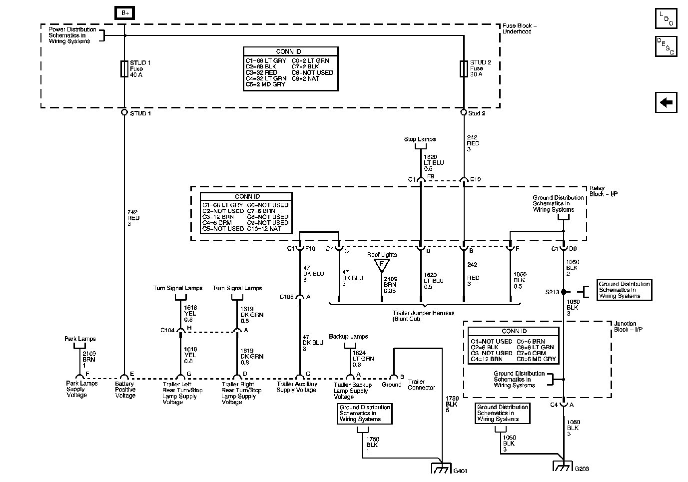

Old 11-17-2004, 11:01 PM
Klaus's Avatar
Klaus Klaus is offline
Location: CSA
Posts: 2,511
Here's the schematic:

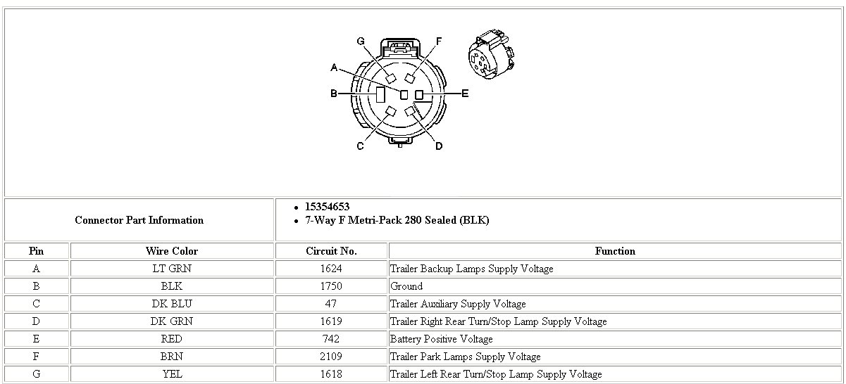

Old 11-17-2004, 11:02 PM
Klaus's Avatar
Location: CSA
Posts: 2,511
Here's the trailer connector:
Old 11-17-2004, 11:05 PM
Klaus's Avatar
Location: CSA
Posts: 2,511
Based on this, Pin "E" (Battery) is fused for 40A through stud 1 of the underhood fuse block.
Old 11-18-2004, 12:08 AM
Personally, I would run you another wire. I am not sure about the trailer wiring crap. I have run trailers on my '03 since I have had it and had power to the pin on the plug. A few months ago when looking at something else I noticed the wiring diagram saying that the 12V pos to the trailer plug ran off of stud 1. Well I didn't have a fuse in plug 1, it had a little red plastic dust cover looking thing in it, but I still had power back there.
So, who knows where or IF mine is fused. It might be hooked up to stud 2 but I never checked.
Old 11-18-2004, 12:59 AM
H2Finally's Avatar
Posts: 1,814
Thanks guys!!
Klaus, my trailer connector is configured differently. From the drawing you provided, my ground is in position "C" (8 o'clock) and battery is in position "F" (2 o'clock). This is both as diagramed on the cover of the connector, as well as verified with a voltmeter. All other positions are not powered with engine off.
Perhaps an 04 difference? Though my Stud 1 also just had that plastic plug cover...
