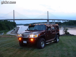

Originally Posted by Tex_h2
Ok, never mind....work like a charm now.....don't ask......
Pic
