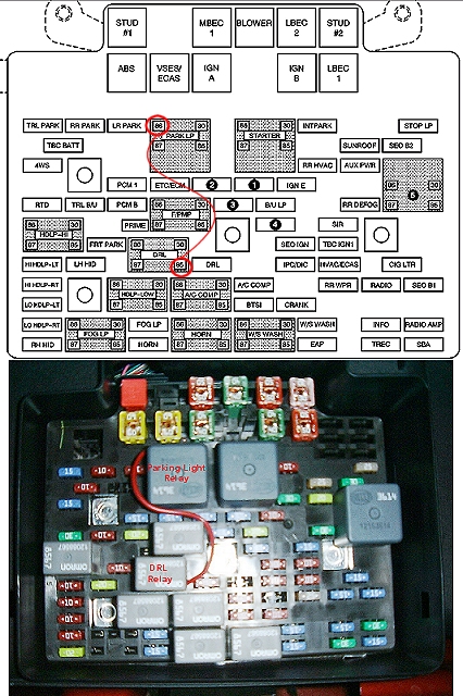

Jump the #86 term from the parking light relay to #85 of the DRL relay. (Actually, the schematic is wrong and if you look at the bottom of the DRL relay it's actually #86. Doesn't matter anyway for this application).
Here's the pic of the jumper...Only draw back is unless you use another relay, your parking lights will be on when your DRLs are on and vice versa. Going the later route will be more involved.
The relays are a pain to lift. Use a flat blade screwdriver and GENTLY pry lose. Strip both ends of a wire and insert into terminals. Push in relay to hold in place.
#86/85 are low current terminals so you don't really need a really thick guage wire. Get one about 1/8" or so.

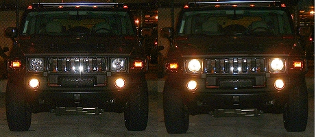

Pics with lights...

But do you mean that this way the parking lights and DRLs can and must only be on simultaneously? Driving by day AND night?
Solution would be then to turn off both during daylight. Especially where I live, because I get flashed often during the day by people who think I left my lights on unknowingly...

Already done. It occurs to me that I never use the parking light setting anyway, only the auto function. Forgot, I've got the Bosch off road lamps, too. I get so many people flashing me now thinking my brights are on. This'll be fun.

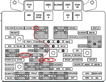

Forgot to mention that before removing the relays, pull the parking light and drl fuses (circled in red below) to prevent potential shorts caused by the flat blade screwdriver.
Once the jumper has been installed, put the fuses and relays back, but don't fully seat it until after verifying that the lights work. This way, it won't be too much of a pain removing the relays again.

The first thing was recognizing there are relays for DRLs and parking lights (this saved us a lot of time and $$). Next is to use a volt meter to find which terminal turns the parking relays on. Finally, use that same signal to power the DRL relay.
The tricky part was that the schematic is wrong for the DRLs. #86 is actually used for both relays, but the schematics listed the DRL as #85. I did this w/o the volt meter, but couldn't getting it working correctly. Only by using the volt meter was I able to find out where the problem was.
