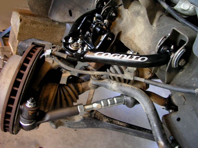

Get the Fabtechs - don't let <THIS> happen to you!
Here's a pic of my Fab's:
'05 H2 Lux, 37" KM2's on 17" Hutchinson Double Beadlocks, Cognito UCA's, Cognito Sway Bar Links, Custom Hydro-Assist Steering Upgrade, Eaton Front Differential Locker, 1" Rear Coil Spacers, Chevy Green Key Torsion Bar "Lift," Bilstein Shocks, Warn 9.5ti Multimount Winch, Dual Optima Yellow Top Battery's, Piaa & Hella Off-road lights, Gobi Rack, Tru-cool External Transmission Oil Cooler, Diablo Predator Hi-Octane Tune.
