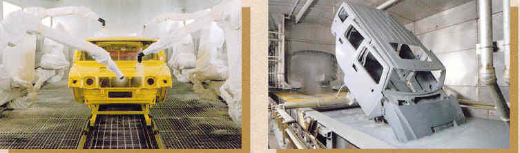

In the book by John Lamm & Matt DeLorenzo titled: "HUMMER H2" --- they show a very interesting picture on page 90 showing a nearly completed body of an H2 going through a "ro-dip" electrolysis tank to apply undercoating. According to the caption of the picture, "This unique system turns the vehicle while it's being coated eliminating air trapped beneath horizontal body panels, giving them a uniform layer of undercoating."
Evidently this is later connected to the frame?
Wonder why they don't "ro-dip" the frame too?

The rust is not on the frame which was dipped, but on the underbody parts. I don't think any Hummer should have any rust through problem in the future years. I can understand the anger toward GM about the rust and their lack of help, but once you accepted the reality and get over that, you'll find the problem is a minor one, easy to fix and cost very little. The sooner you fix it as Phil did, the sooner you'll get pass it, forget it and move on.
