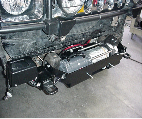

Paragon,
No need anymore. I just got the install instructions in Word form from Warn. The pictures in it provide enough detail.
For others, this picture shows how it all fits together before adding the bumper cover.

For others, this picture shows how it all fits together before adding the bumper cover. </div></BLOCKQUOTE>Damn, I was just resizing all of the photos and getting ready to post them. Hmphf!
