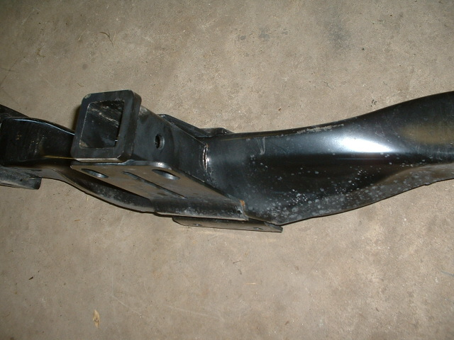

Carefull pulling too hard on your reciever mount. This is what my rear receiver looks like after I pulled too hard on it. I did this with a 8000# Warn and a double line through a snatch block trying to pull a dead stump out of the ground.
Don

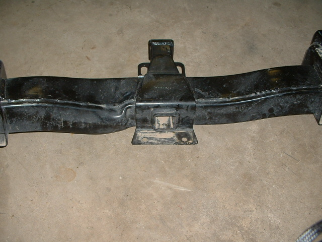

Here's the other side,notice how the weld tore out of the crossmember where the receiver joins it.
Time to build a stronger crossmember that will withstand the strain of heavy winching.

<BLOCKQUOTE class="ip-ubbcode-quote"><font size="-1">quote:</font><HR>Originally posted by Hummie2:
Time to build a stronger crossmember that will withstand the strain of heavy winching.<HR></BLOCKQUOTE>
Ouch! Since the front receiver is about one third as strong as the rear, it goes without saying that winching can put damaging stresses on the equipment...
Thanks for the pictures!
Are you going to replace that damaged hitch with a Class V hitch now?
Ed

<BLOCKQUOTE class="ip-ubbcode-quote"><font size="-1">quote:</font><HR> Are you going to replace that damaged hitch with a Class V hitch now?
Ed <HR></BLOCKQUOTE>
I don't know if any aftermarket receiver hitches are available for the H2 yet. I did a search, but didn't find any listed for it. Let me know if you know of any.
I will probably end up and build something heavier and stronger than what came stock on the hummer.
Don
