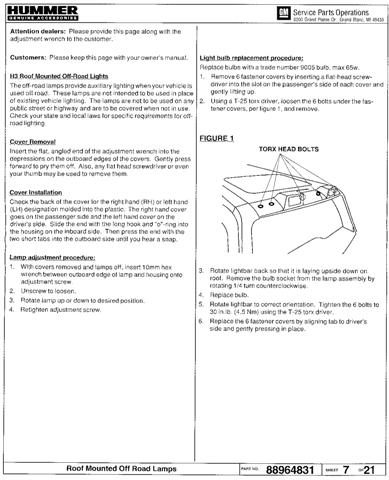

I can't find Sylvania 9140/37 watt anywhere.
Wonder why they left this info out of the manual?
I wiil have to look later, they are not easy to get at.
I had access to them before,when I had to remove the entire front end, when I installed the Brush Guard.
I know For fact the headlights are 9008 (H-13) 60/55 Watt.
and the off road lights are Sylvania 9005 (HB3) 65 Watt.
I am glad that I checked the bulbs on my "off road lights" before I installed them.
Because you have to remove the entire thing to change the lamps.
I want to replace all of my lights with the same type/brand at the same time and before I install the off road lights.
I do not want the higher wattage lamps though, just the very white. (I don't want to melt anything)!
http://www.automotivelightingusa.com/index.php?main_page=index&cPath=10
PS I just found this info on eBay I do not know for a fact how acurate this is:
(H10 and 9005 bulbs are interchangeable in the same light housing. 9005 are just higher wattage bulbs than H10)

OK! Here's the scoop! I pulled one of my fog light bulbs. I managed to get at them without taking anything apart. My skinny arms were just barely abble to fit way up in there.
The fog light bulbs are Marked "9140 / 37W".
The off road bulbs are marked "HB3 / 9005 / 65W"
They are not interchangable!
The 9140 has a coating on the end and the 9005 does not. Also The bulbs will not fit into holes, the tabs do not line up.
The "HB4 / 9006 / 55W" will not fit anywhere on the H3. Not only will it not fit into the holes, the plug will not fit (there is only 1 tab in the socket)
The only bulb that I could find that will work besides the "9140" is the "H10 / 9145 / 42W".
There is also a "9045 / 45W" and a "9040 / 48W"
They look the same, but the filliment runs left to right instead of up and down like the "9145" and "9140"
Why do they have to make things so difficult?
So after spending alot of trial, error, time, and money, I learned alot about light bulbs!
Now I am sharing it with you all.
So that was your lighting lesson for today.
By the way, I could have just listened to Webb70 to begin with!
