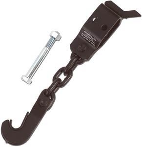

I think my hi-lift is in the same barn. They make a little chain dealie that hooks to your bumper but I haven't seen how well they work on the tow hooks of the H2. You could probably contact Trail Duty to get one of these:

Gotcha, We are on the same sheet of music. The tube steps will definitely come off, based on the massive piles of sand which came home on them the other day. If they were rocks I was goin over, they'da been toast. That Hook deal looks like it would probably work great. If anyone has one, do you know if the rocker bar will fit in that hook. If so that would be great, maybe with a little skateboard tape on the underside of the bars and maybe some on the inside of the hook for extra grip when things get wet. Congratulations Paragon with the little crumb snatcher on the way. Just curious, is this your first?

Gotcha, We are on the same sheet of music. The tube steps will definitely come off, based on the massive piles of sand which came home on them the other day. If they were rocks I was goin over, they'da been toast. That Hook deal looks like it would probably work great. If anyone has one, do you know if the rocker bar will fit in that hook. If so that would be great, maybe with a little skateboard tape on the underside of the bars and maybe some on the inside of the hook for extra grip when things get wet. Congratulations Paragon with the little crumb snatcher on the way. Just curious, is this your first? <HR></BLOCKQUOTE>I don't think the hook will work on the rock rails but you should be able to put the lip of the jack up under the rock rail itself.

I'm wondering if a tree saver strap wrapped around the rockrail would work in an emergency situation.
I'm not sure f the weight capacity of the strap, but I'm sure it would hold up enough to get you out of a sticky situation.

Hi-Lift also has a new tire lift hook accessory. Seemed ideal, since the whole objective is to lift the tires and stack stones under em?

Ok, used it first time today. The rocker bars work fine. But DEFINITELY USE WITH DOOR OPEN!! (the top of the bar tilt in when jacked, would cause body damage if door was in the way).

I saw a picture of the tire lift, but it seems to me that if you need to jack, your tire would probably be pretty buried in the muck. Anybody have any actual experience with one?
