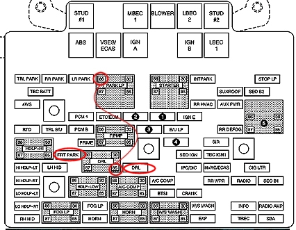

<BLOCKQUOTE class="ip-ubbcode-quote"><font size="-1">quote:</font><HR>Originally posted by ZeroTolerance:
89vette:
There are a bunch of HID like bulbs out there and I think that you would be happy with most of them, I have a set that I bought online from a light retailer and they are 6000K which I think is one of the brightest bulbs available on the market. They are kind of pricey but I think that the light they emit is worth the money. I would also suggest getting a pair of bright white lights for the DRL as well. Then you will have the full bright white front look and if you run the cross over for the DRL's then you will have more light then.... Good luck... PIAA makes some good ones as well....Do a search on here and you will find tons of topics on this matter....<HR></BLOCKQUOTE>
Zero,
How do you run the cross over for the DRL's?

Old 11-13-2003, 03:02 PM
Dan Dan is offline
Location: Cognito
Posts: 2,155
This jumper is so the DRLs stay on with the headlights:
SUT on order 12/02. 11 months down, 7 to go!

I put the SilverStars in tonight, they are better than the OEM bulbs but I sure miss my HID's (Lincoln Navigator)
Dan: Thanks for the Diagram, now I have something to do tomorrow.
