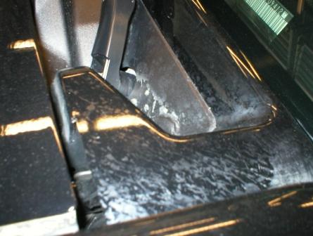

I haven't seen your problem, but could this be it? It may be a different problem, but I would guess black may show it better than other colors.
Cloudy Spot in Paint After Protective Covering is Removed (Heat Area) #05-08-51-005 - (Sep 21, 2005)
2005-2006 GM Passenger Cars and Trucks
2005-2006 HUMMER H2
2006 HUMMER H3
Condition
During Pre-Delivery after the Wrap Guard ® has been removed, some cloudy spots may be present in the clear coat.
Cause
The Wrap Guard® may have had some air bubbles or creases under the material where water may have collected.
Correction
DO THIS: Use heat gun to remove the spot.
DON'T' DO THIS: Do Not paint the panel.
Apply heat to the spot using a heat gun for 10 seconds, making sure not to burn the paint.
(ME TOO)

Drtyfn, The dealer is very much involved. It is apparently a problem that is new and I want to see if there is anybody else out there with a similair problem.
F5fstop, thanks for the info. the dealer told me about the issue you describe he said it looks similair but could not resolve it the same way.
Below is a picture of the part below the wipers. This is how it was. It is now polished and looks much better. The flairs and ventcaps were like this, also these look much better now after polishing but depending on the light reflection you still can see some of the old spots.

I really dont think its a paint issue.
Having mud bogged for years, with custom painted high end vehicles, I would often have spotting issues realted to mud.
Racing mud pits were notorious. Also landfill areas, areas where water would sit year long, etc....
Some mud have environmental elements that attack paint. It can be naturally occurring or or from contaminants. Some mud/soils are highly acidic, some are alkaline.
Plastic poly's are prone past a certain point.
Lengthy exposure to this type of chemical attack only makes it worse.
Rinsing as soon as possible is the only real detterent from damage.
You got plain ole mud staining

<BLOCKQUOTE class="ip-ubbcode-quote"><div class="ip-ubbcode-quote-title">quote:</div><div class="ip-ubbcode-quote-content">Originally posted by H3Eric:
Below is a picture of the part below the wipers. This is how it was. It is now polished and looks much better. The flairs and ventcaps were like this, also these look much better now after polishing but depending on the light reflection you still can see some of the old spots. </div></BLOCKQUOTE>
That almost looks like some type of etching common with acid rain...a big problem in some areas.
I'm thinking HummBebe might be correct.
(ME TOO)

Update:
All the fiberglass parts of my black H3 will be replaced with new ones from GM and the damaged ones will be returned to GM for futher investigation to get a better understanding of the problem and see if this is a common issue or just a bad batch.
