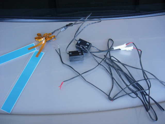

Ok, Here is a pic. It looks simple but maybe someone with wiring experience can tell me which wire to connect these two (2 red/ 2 black). I am not into chopping the wiring on my $50,000+ truck...FYI, the wire schematic is on pg 1 of this post.

Hmmm. I see two white plugs, each with a red and a black wire. But at the end of the wire pairs, I see one set of black and one set of red.
Do the wires change color in the wrapping or do the wires get switched somewhere so that the reds and blacks end up together?

The wires get switched inside the coverings. I think I can just put both blks on the same connection and the same with the reds.
I can't believe No one knows which wires I can hook these too. I took taz advice and found the wires to a kick light which is activated only when I open the door but I dont know which wires (red or blk) to hook up to the light wires (blk or blkw white stripe).
The red only needs a "hot" source(only when doors are opened) and the blk needs to go to a ground. The clips are just for a quick disconnect.
Does anyone know how to test the car light wires to see which one is hot and the ground?

1. Here are the wires with the kit. Also don't forget to turn off the dome lights using the switch next to the headlight switch( this will make the wires you are working with "dead" so you don't get shocked or short out anything).

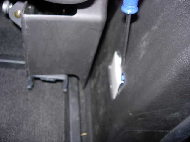

2. Locate the kick panel light which is behind the driver/passenger seat repectively. Pop the cover off using a small bladed flat head screwdriver (from the top is easiest).

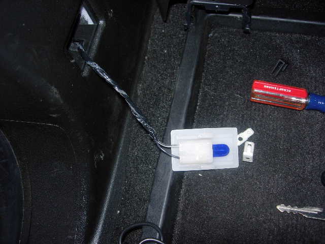

3. This is what it looks like with the light opened, exposing the 2 wires needed for wiring.
4. Now pop open the plastic covering where the kick panel lights are located (It is held with only clips and pops open easily). This will allow you to run the door sill wires through the kick panel light opening.
