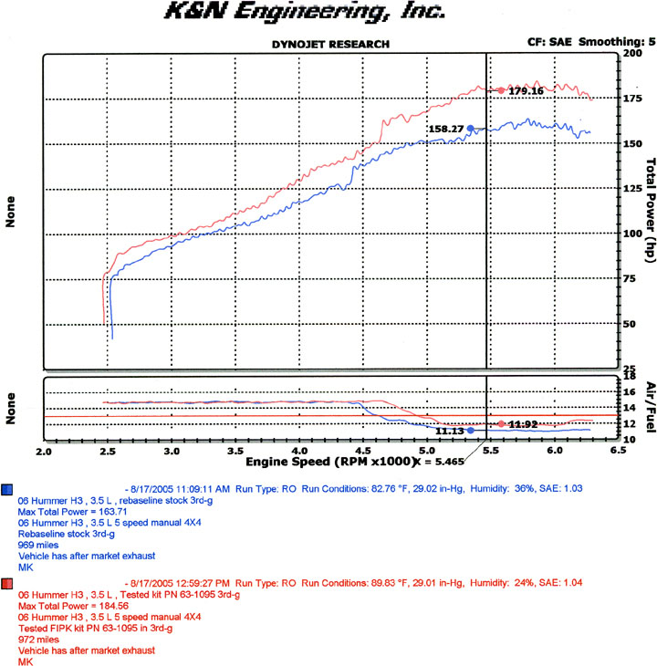

Dynochart for K&N Intake Kit:
2nd Gear Testing on 5 speed manual
Tested with Magnaflow Cat Back Exhaust
Power measured at wheels
Favorite Off Road Trips: Death Valley & Joshua Tree
Off Roaded Vehicles: H2, Yukon, Suburban, Jeep Wrangler & Unlimited
Old 09-02-2005, 01:32 PM
WhiteH3 WhiteH3 is offline
Posts: 60
WhiteH3 is off the scale
3rd Gear Testing on 5 speed manual
