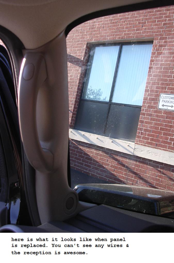

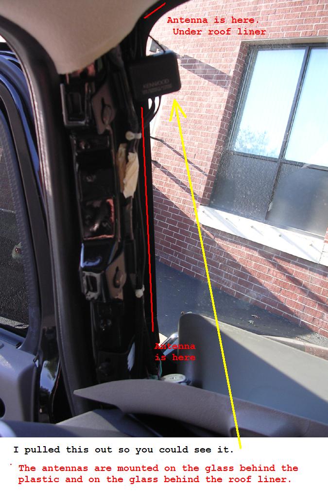

The TV tuner works great, the antenna must be on glass for them to work. I
did not want to mount them on the rear window. I didn't want to see them inside the car at all. I took some pics of where I put them so you can see.
It has 4 antennas 2 have to mount vertical and 2 horizontal to get the best
reception.
No problem at all.
Garry

Here is the other photo. You can't see the antennas at all when the plate is put back.
