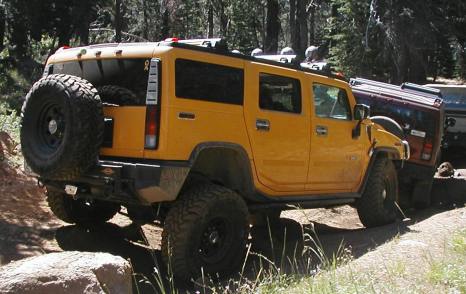

Rodster,
I have the Toyo 37's on stock rims. Love the result. Minor rubbing in front resolved when I put on the Fabtech HD steering components.
Also had one air bag sensor connecting rod get broken by the tire on the right rear..
see pic below
also view this link
http://elcova.com/groupee/forums/a/t...1/m/2921015421
Overall VERY glad I went with the 37x13.5x17's

Rodster
if you go with the 9.5 rims it WILL rub on the inner fender and front stabilizer bar. I was able to put the 13.5 tires on only because I kept the stock 8" rims with the factory off set. Do not try this with after market rims. Unless your never going off raod!!!

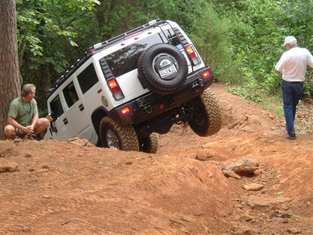

Old 08-08-2005, 04:22 PM
Doc,
I ran out to Brown's Camp last week and tried them out on Hog's Back. Usually I need to reposition once when going up HB, but with the Toyos I walked right up and never even slipped a tire.

Old 08-23-2005, 06:15 PM
37x13.50s on aftermarket rims, no lift, fabtech steering. only rub is on the plastic fenderwell when i'm doing a uturn. or articulating a bit, but even this one barely had the driver's side rubbing
